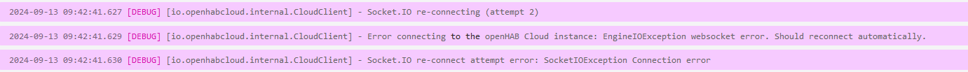

OH version:
Debug log:
Please find in the attachemnt full log after bundle org.openhab.io.openhabcloud restart from karaf console.
openhab.log (148.9 KB)
Is something blocking your openHAB from talking to the outside world, those errors look like its not even reaching our service. Also did you notice this in your logs?
2024-09-13 09:42:33.433 [WARN ] [ity.CommunityMarketplaceAddonService] - Unable to retrieve marketplace add-ons: community.openhab.org
That looks to me like our addon service can also not reach the outside world
It seems that you were right. I did DNS check and there is a problem with ubuntu archive connection.
After manually change DNS to google 8.8.8.8 on ubuntu machine - everything starts to work properlly.
Thank you for your time and hints !!
