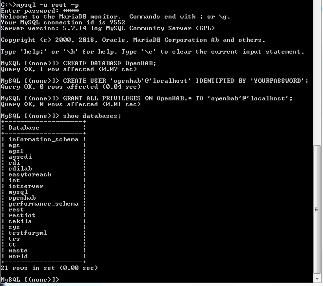

Did you create the Database? I case you did not, do the following and/or follow this tutorial openHAB2 & MySQL persistence setup
While we are at it… maybe consider using InfluxDB instead of MySQL because this => InfluxDB+Grafana persistence and graphing

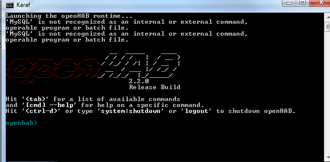

  1. Use the normal shell/terminal not openhab-karaf
  2. Fire up this command to login into your mysql server mysql -h localhost -uroot -proot
  3. Fire up this command to list all databases mysql> show databases; (Note that "mysql> is the prompt from the shell)
  4. Check if there is an openhab database, should look something like this
| Database           |
| information_schema |
| mysql              |
| openhab            |
| performance_schema |
  1. If there is no openhab entry, create a Database with this command CREATE DATABASE openhab;

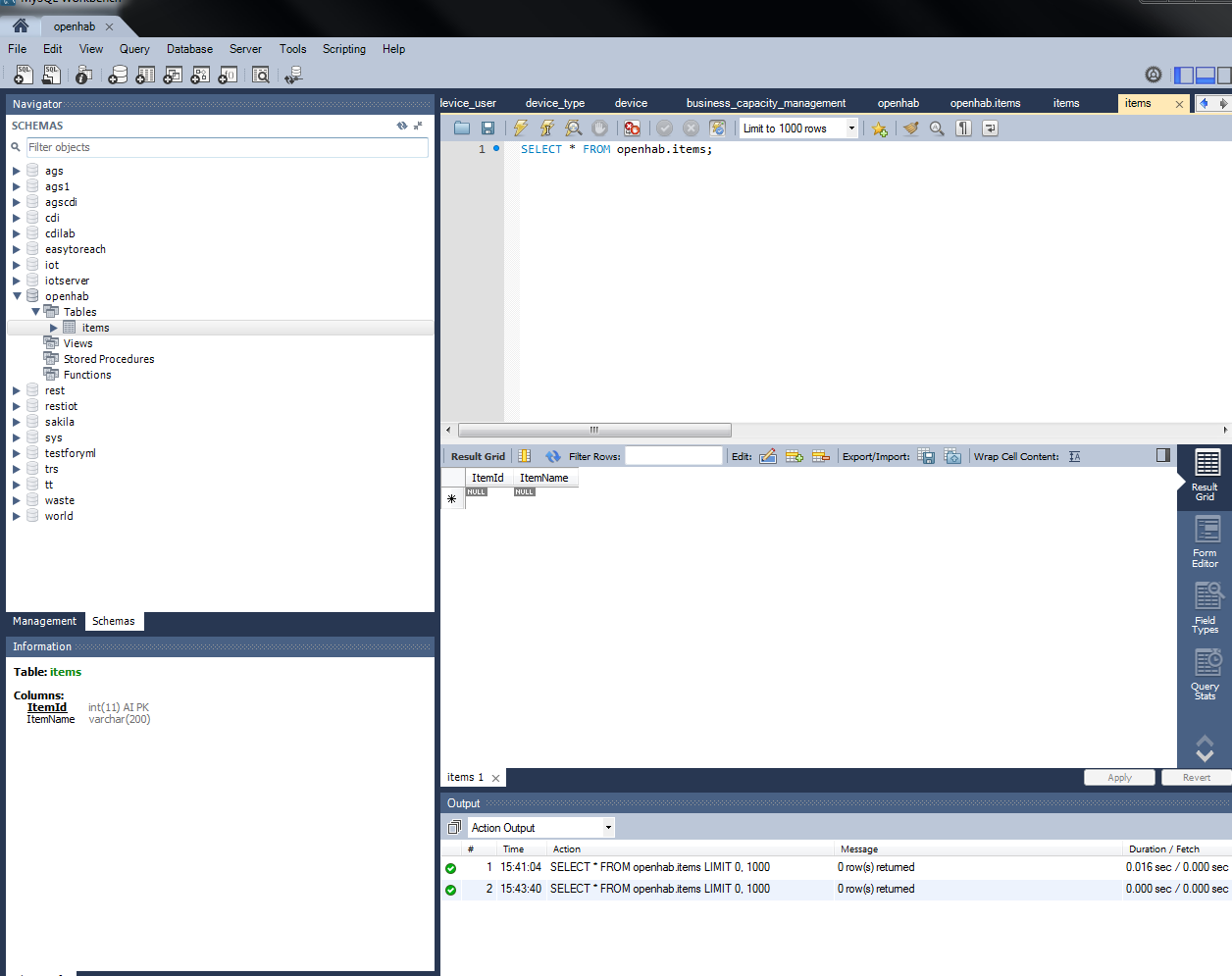

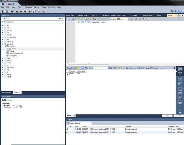

I got openhab in the database, but when go see it it does not contain any of my items.. Am I doing

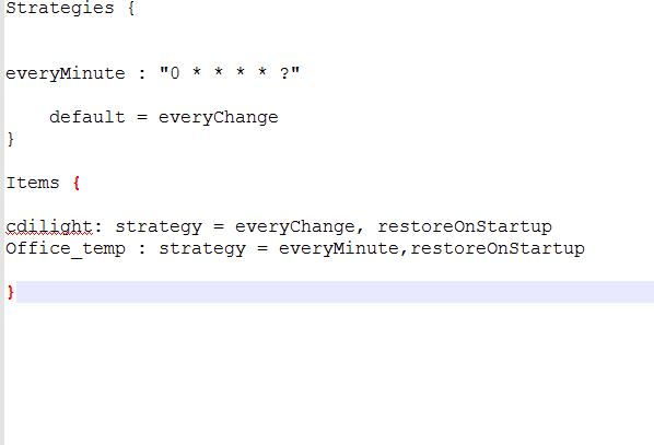

Could you post your mysql.persist?
Also did you create and setup the openhab user for mysql correctly?
mysql.persist
I followed the steps given in the link.. I got openhab in my database but not the items..

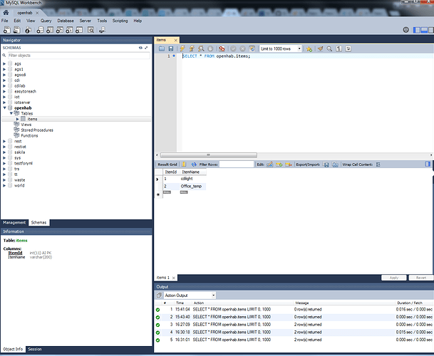

Okay I did a mistake with username and password pardon me, it’s working now :wink: Thank you

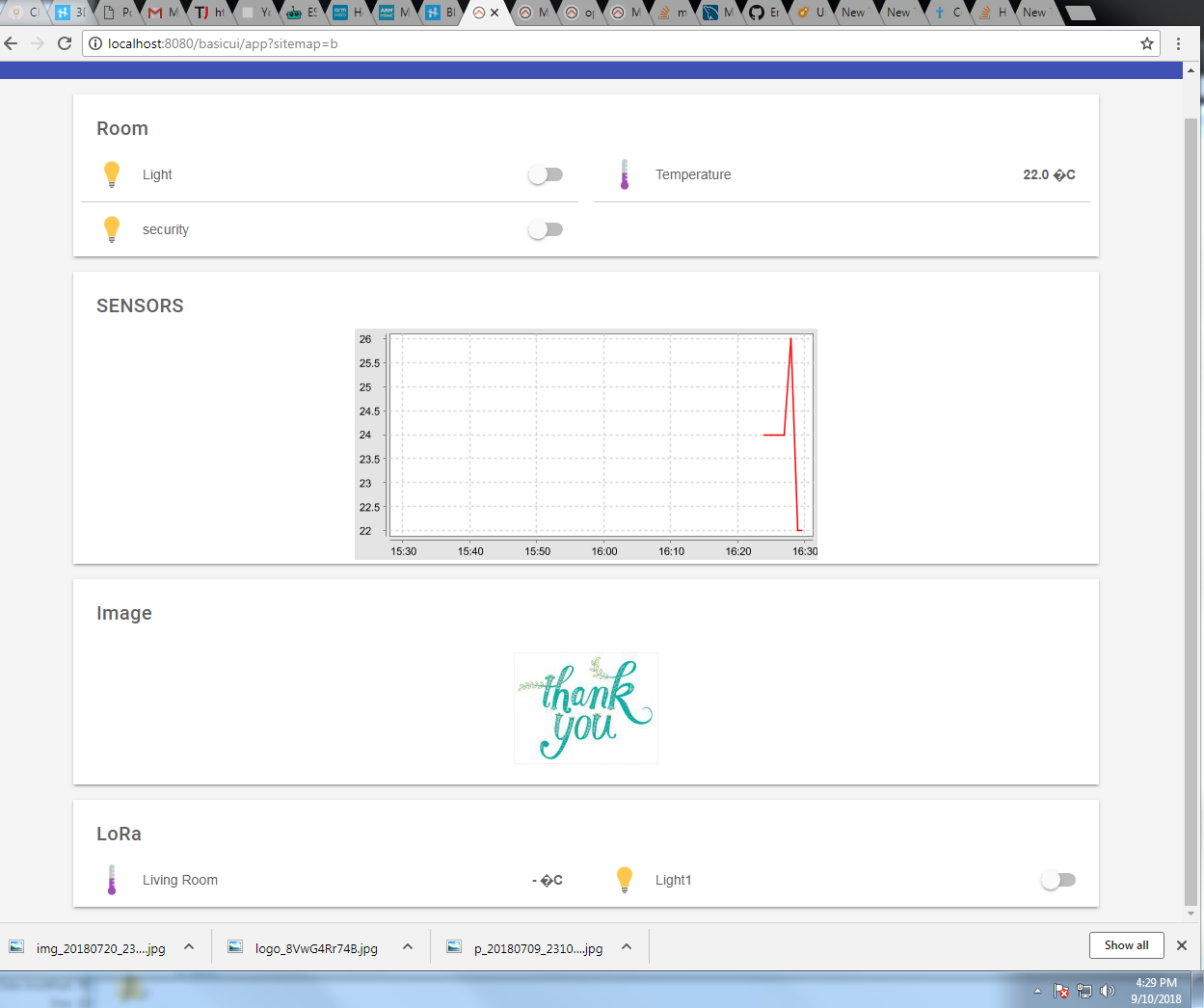

I get the graph..
Msql looks like this.. is it possible to get the temperature value in the database..
There will be two more tables now
Item1 and Item2
Then you can do SELECT * FROM openhab.Item2;
