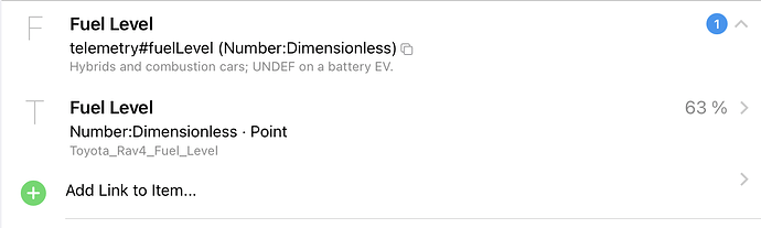

Hi @Nanna_Agesen

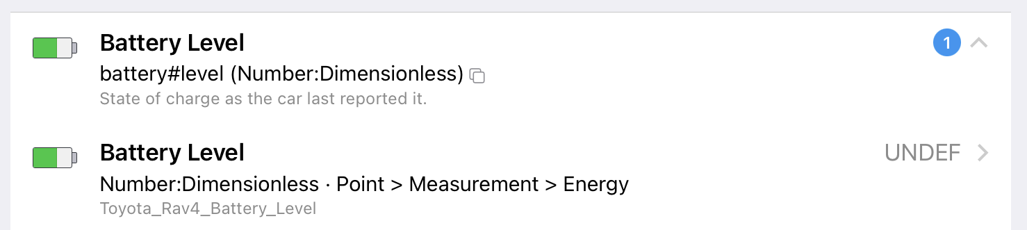

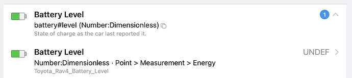

gr8 work on this - i have installed the Jar on a site with a 2025 Rav 4 - seems to be working but I do not its a PHEV Plug in Hybrid and I do not see any capabilities related to the petrol side
I have not yet put it into debug or trace(time constraints) more but wanted to get your opinion on what my next steps should be.

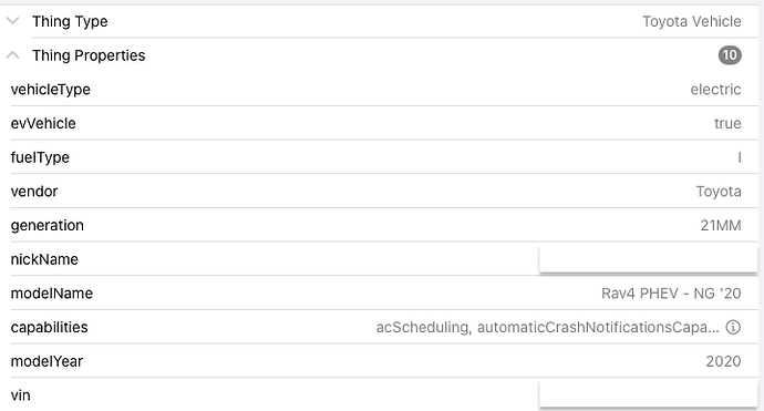

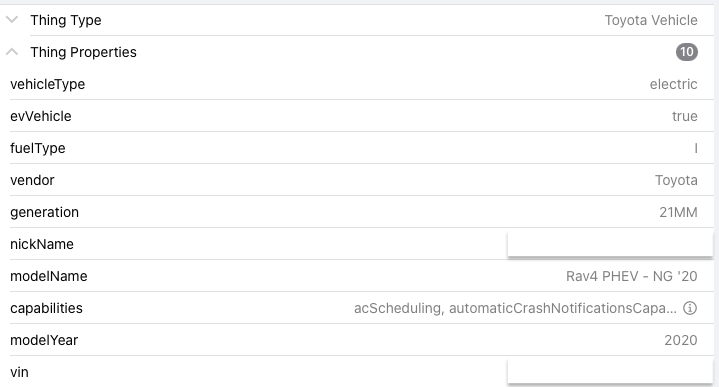

EDIT: the only property on the thing is
vendor
Toyota
Thank you for the report — a RAV4 PHEV is exactly the car this release needed. Two things were behind what you saw. The capabilities and the other properties were only written when the thing came from discovery; a thing from a .things file showed nothing but vendor: Toyota. And the engine-start capability is spelled estartStopCapable in the vehicle list’s remoteServiceCapabilities, which the binding did not look at — it only knew remoteEngineStartStop. Both are in 1.8.1: the binding writes the properties itself on the first poll (including fuelType and vehicleType), and both spellings count. 1.8.1 also adds fuel consumption in l/100 km per trip and per month, today’s fuel, the four parts of the driving score, service notes, and for your car battery#usableLevel and battery#totalRange (fuel + EV). Cars without a battery are no longer asked for one. Please post your capabilities property once it appears — it tells us which of the petrol-side channels your car reports.
Hi @Nanna_Agesen thanks for the quick reply
I deleted and rediscovered the Car with the new version (its is now collecting data and I will monitor and advise)
These are the capabilities now
acScheduling, automaticCrashNotificationsCapable, bonnetStatus, chargeManagement, chargeNowCapable, doorLockUnlockCapable, drivingAnalyticsCapable, econnectClimateCapable, econnectVehicleStatusCapable, evChargeStationsCapable, frontDefogger, frontDriverDoorLockStatus, frontDriverDoorOpenStatus, frontDriverDoorWindowStatus, frontPassengerDoorLockStatus, frontPassengerDoorOpenStatus, frontPassengerDoorWindowStatus, fuelLevelAvailable, fuelRangeAvailable, guestDriver, hazardCapable, hybridPulse, lastParkedCapable, lightStatus, moonroof, nextCharge, rearDefogger, rearDriverDoorLockStatus, rearDriverDoorOpenStatus, rearDriverDoorWindowStatus, rearHatchRearWindow, rearPassengerDoorLockStatus, rearPassengerDoorOpenStatus, rearPassengerDoorWindowStatus, remoteEConnectCapable, smartKeyStatus, sunroof, telemetryCapable, vehicleDiagnosticCapable, vehicleFinder, vehicleStatus
and these were the channels it created:
		Type battery-level : battery#level "Battery Level"
		Type range : battery#range "EV Range"
		Type range : battery#rangeWithAc "EV Range with A/C"
		Type charging-status : battery#chargingStatus "Charging Status"
		Type charging-schedule : battery#chargingSchedule "Charging Schedule"
		Type next-charging-event : battery#nextChargingEvent "Next Charging Event"
		Type charging : battery#charging "Charging"
		Type remaining-charge-time : battery#remainingChargeTime "Remaining Charge Time"
		Type battery-level : battery#usableLevel "Usable Battery Level"
		Type range : battery#totalRange "Total Range"
		Type timestamp : battery#lastUpdate "Battery Reported"
		Type odometer : telemetry#odometer "Odometer"
		Type range : telemetry#distanceToEmpty "Distance to Empty"
		Type fuel-level : telemetry#fuelLevel "Fuel Level"
		Type timestamp : telemetry#lastUpdate "Telemetry Reported"
		Type timestamp : trips#latestStart "Latest Trip Start"
		Type timestamp : trips#latestEnd "Latest Trip End"
		Type trip-distance : trips#latestDistance "Latest Trip Distance"
		Type trip-duration : trips#latestDuration "Latest Trip Duration"
		Type trip-speed : trips#latestAverageSpeed "Latest Trip Average Speed"
		Type trip-fuel : trips#latestFuel "Latest Trip Fuel"

Thank you — that is exactly the list I hoped to see, and it answers the “petrol side” question: your car reports fuelLevelAvailable, fuelRangeAvailable and hybridPulse, so telemetry#fuelLevel, telemetry#distanceToEmpty, battery#totalRange and the l/100 km trip channels should fill as the car drives. Two things I would like from you when you have a moment:
Does the MyToyota app offer remote engine start for your RAV4? Your capabilities carry neither remoteEngineStartStop nor estartStopCapable, so the binding created no control#engine — if the app has the button, Toyota is signalling it with a flag I have not seen yet, and I will add it.
Once a trip or two has landed: what battery#usableLevel, battery#totalRange, trips#latestFuelEconomy and trips#latestEvDuration read, and whether they look right against the app. The thing’s vehicleType property should say plug-in hybrid (fuelType I).
hybridPulse, smartKeyStatus and bonnetStatus are flags I have not mapped to anything; if you ever see something in the app those could correspond to, say so — with a DEBUG log of the binding the payloads behind them are visible, and that is how the next channels get built.
the car is reporting “electric”

Hi @BrettLHolmes — thank you, that capability list and those four values were exactly what was needed. Two of them turned out to be my bugs; both are fixed in 1.9.4, which is up now.
“The car is reporting electric” — your car is right and the binding was wrong. Toyota’s registry returns fuelType: E for your RAV4 PHEV, and both this binding and pytoyoda take that at face value. But the same payload also says fuelLevelAvailable, fuelRangeAvailable and hybridPulse, and a car that reports a fuel level is not a battery car. From 1.9.4 the capabilities win over the code, so the thing will say plug-in hybrid. It is only a property and a log line — nothing else keys off it.
Usable Battery = UNDEF — my fault, and worse than it looks. 1.8.x and 1.9.0 read a field called phevUsableBatteryLevel, a name that exists neither in pytoyoda nor, apparently, in your car’s payload, so the channel was empty on exactly the cars it was written for. I am not going to guess another name: from 1.9.4 the binding takes any numeric field in the electric payload whose name contains “usable” and logs at INFO which one it found. If your RAV4 has one under a different name it will simply appear, and the log line tells us what to call it. If nothing shows up, the endpoint does not carry it for your car and the channel stays UNDEF.
Latest Trip Consumption = 0.0 l/100km — I believe this one is correct. The binding gives UNDEF when the figure is missing and only prints a number when the car sent one, so 0.0 means your car reported zero fuel for that trip, which is what a trip driven on the battery uses. Worth a sanity check: compare Latest Trip EV Distance with Latest Trip Distance. If they match, 0.0 is the honest answer.
Total Range the same as Distance to Empty — this one I would like to understand. Total Range is fuelRange + evRangeWithAc from the electric endpoint, the way pytoyoda’s dashboard adds them, so the two being equal means the EV part came back zero or missing. Was the battery flat at the time? If it was not, one line from the log would settle it:
A correction to my own post above, and a new release: 1.9.5.
I wrote that fuelLevelAvailable and fuelRangeAvailable proved your car has a tank. They do not. A bZ4X — a car with no engine at all — advertises both as true, so 1.9.4 turned round and called every battery car a plug-in hybrid. Apologies to anyone who installed it in that hour: the damage is one property and one word in a log line, and 1.9.5 puts it right.
What actually separates the two cars is hybridPulse: false on the bZ4X, true on your RAV4. That flag alone now decides, and only for a car Toyota’s registry already calls electric, so a full hybrid never reaches the test.
Everything else in 1.9.4 stands, the usable-battery change included.
Hi @Nanna_Agesen
I have 1.9.5 installed
I deleted the links and the thing and rediscovered and seems the battery info is not being populated and the fuel level is now the battery level happy to continúe if needed testing as not in production (yet )

  1. A link is on the wrong channel. You deleted the links and the thing and rediscovered, so every link was made fresh. An item that landed on battery#level instead of telemetry#fuelLevel would look exactly like this.
  2. Toyota is sending it that way. If fuelLevel genuinely comes back as the battery percentage for your RAV4, the binding is faithfully showing what arrived, and the fix belongs in the binding — but it has to be the right fix.
Three things would settle both halves of your report. Whichever is least trouble:
  • Which channel your fuel item is linked to. In the UI, the item’s link shows the channel name under the thing.

Hi @Nanna_Agesen @pologies on the delay i have not been able to access the car/app for the last few days and should be able to confirm tomorrow.
Will advise.
I have good news for you - seems i was to hasty at looking at the data in the Items - I had deleted all the items and re-added them
All is working correctly - i think what confused me is that the Fuel was called a % which is understandable (but i did not expect it like that)
Thanks for a great binding.
