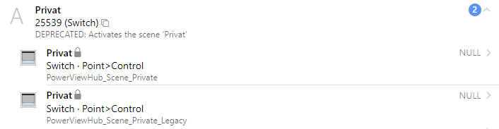

I was trying to do something like this when migrating from channel without channel group (e.g. 25539) to channel linked to a channel group (e.g. scenes#25539) which seems like a normal migration path as a binding evolves:
ChannelGroupUID channelGroupUid = new ChannelGroupUID(thing.getUID(), HDPowerViewBindingConstants.CHANNEL_GROUP_SCENES);
for (Scene scene : scenes) {
String channelId = Integer.toString(scene.id);
ChannelUID channelUid = new ChannelUID(getThing().getUID(), channelId);
String description = translationProvider.getText("dynamic-channel.scene-activate.deprecated.description", scene.getName());
Channel channel = ChannelBuilder.create(channelUid, CoreItemFactory.SWITCH).withType(sceneChannelTypeUID)
.withLabel(scene.getName()).withDescription(description).build();
logger.debug("Creating deprecated channel for scene {} to probe for linked items", scene.id);
updateThing(editThing().withChannel(channel).build());
if (this.isLinked(channelUid)) {
logger.warn("Created deprecated channel for scene {} ('{}'), please link items to '{}' instead",
scene.id, scene.getName(), new ChannelUID(channelGroupUid, channelId).getId());
} else {
logger.debug("Removing deprecated channel for scene {} since no linked items", scene.id);
updateThing(editThing().withoutChannel(channelUid).build());
I had five items linked to the new channels (with group) and one item linked to old channel without group (also linked to one with group). Unexpectedly the new channels were detected as linked as it seems group is not considered in this scenario:
