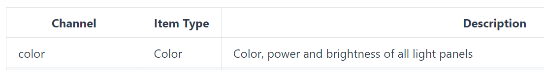

Usually the brightness and/or color channels of lights can be used for on/off control. In Nanoleaf’s case, it appears to be the color channel for all three. So just create a switch item attached to that channel.
Thank you, creating a switch item for that channel made the trick. I never thought this is actually possible.
