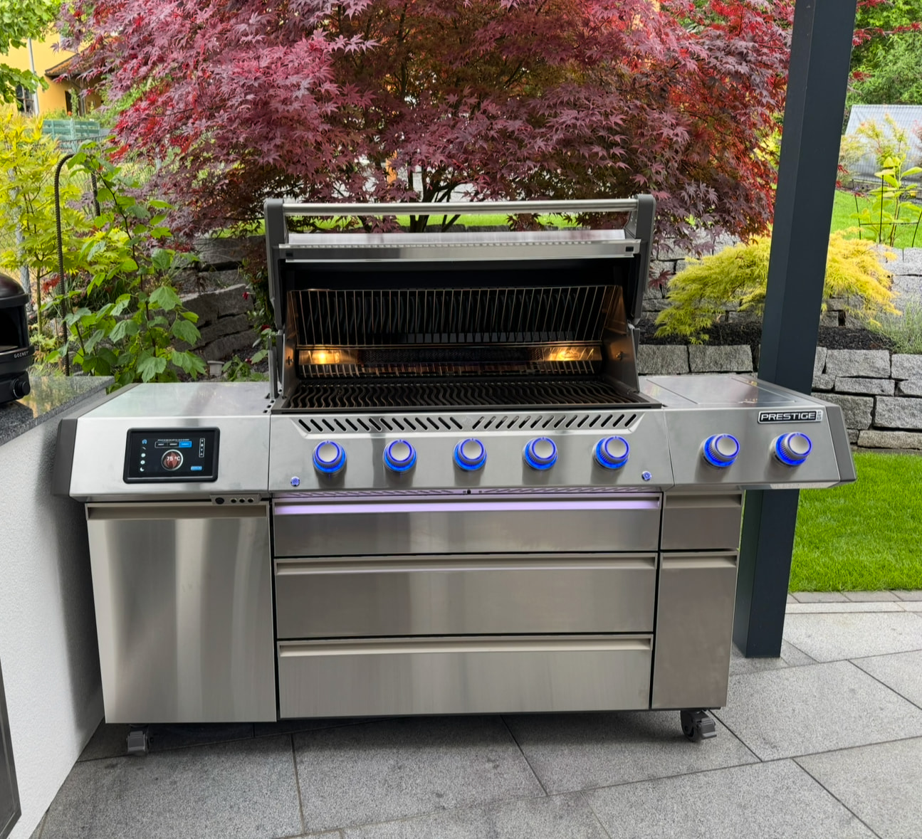

Hey all,
I recently got myself a Napoleon Prestige PRO 665 Smart-Connected grill (the EU variant, item no. PRO665VXRSIBPSS-DE) and went down the rabbit hole of reverse engineering its cloud API to build a proper openHAB integration. Thought I’d share everything I’ve found in case anyone else here sits at the intersection of “serious grilling” and “smart home”.
Background
The grill uses Ayla Networks as its IoT backend — the same platform used by several appliance manufacturers. All communication goes through Ayla’s EU cloud (ads-eu.aylanetworks.com). There is no local APIlan_enabled is hardcoded to false on the EU firmware and can’t be changed via the consumer API. Cloud-only for now.
I used HTTP Catcher on iOS to intercept the Napoleon Home App traffic and Claude as a reverse engineering partner to work through the API structure.
What’s working
  • Full authentication via the Ayla API (24h token, auto-refreshed at 03:00)
  • Bulk polling of all 87 device properties in a single HTTP call every 10 seconds
  • Live updates for: grill chamber temp, all active meat probe temps (including wireless w1-format probes), gas weight, smoker state/mode, system mode, RSSI
  • Write commands for: power, smoker, all three lights, Knob RGB LEDs
  • Automatic light resync after power-on
