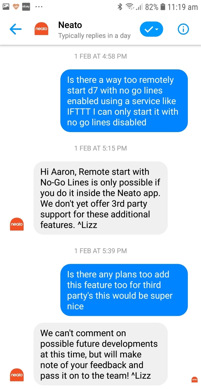

It looks like no go lines are managed by the app
I did speak too neato customer services about it and they said its not possible atm too remotely start the robot with no go lines enabled this is only possible using the app

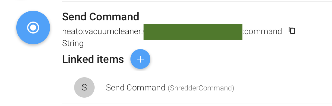

I normally use the BasicUI. But to refresh my memory, I first went to the PaperUI. Then I clicked on ‘Configuration’ and then ‘Things’ below that. I found my Neato Vacuum Cleaner there.
I scrolled through the list of channels and noticed that some had different icons. Then ones that were blue with an inner solid white circle seemed to have “linked items” associated with them. The rest did not.
I found the “Send Command” channel didn’t have a link. So just by chance I clicked the blue icon on the left of the command and a “Link Channel” dialog appeared. I left the profile at “default” and in the dropdown list for “Please select the item to link” I scrolled and found ‘Send Command (FannDammCommand)’ and selected it. Ok… That was it.
I then went to my sitemap in the BasicUI, clicked on clean, and…the vacuum started! Whoa!
“Clean Stop Pause Resume” all seem to work now. “Send to dock” is the only thing that doesn’t do anything.
I really have no idea what I just did, but thought I would share it and see how you guys fare.
Tom
Glad you got it working! Mine still won’t wake up and the channel shows as linked to “Send Command”. Strange.

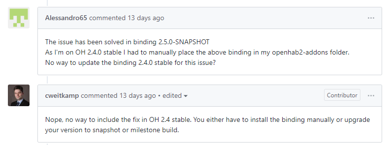

It looks like there is a fix on github for the basic4 error that stops my openhab setup from launching the bot
@vzorglub
sorry for tagging you out of the blue but i noticed you responded in the post previously do you know how too download the updated .jar file from github i have looked around on there but i’m not familiar with the site yet and cant find any mention of downloading
https://github.com/openhab/openhab2-addons/issues/4430
Great, thanks for sharing!
Just did a feature:list | grep ^openhab but probably due to me still running openHAB 2.3 the Neato binding doesn’t show.
So maybe the issue can be resolved once I upgrade to openHAB 2.4 …still waiting for that weekend :smile:
i’m not sure what it does but i ran the same command and found the neato binding
neato
I’m running that version but looking on github it says the fix is not available in v2.4 but will be added to 2.5 only way is download the .jar and i dont know where too find that either
