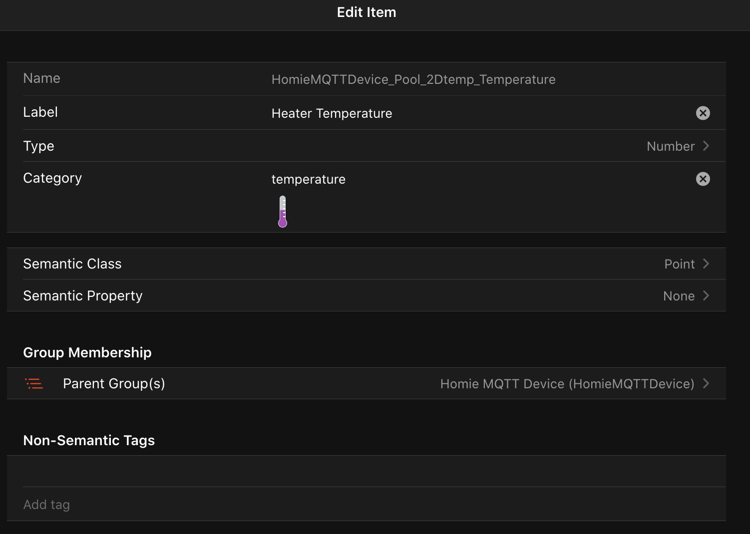

Please show where and how you did define your item?
The copied script is all of it. As for the item, there are several channels in the HomieMQTTDevice. This is the item associated with the pool temperature. I’ve used the relay items in Rules and used this item in pages.

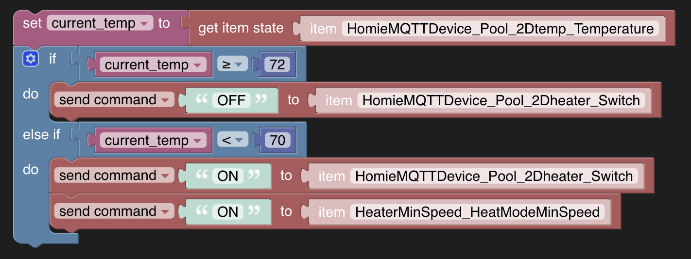

var current_temp;
current_temp = itemRegistry.getItem(‘HomieMQTTDevice_Pool_2Dtemp_Temperature’).getState();
if (current_temp >= 72) {
events.sendCommand(‘HomieMQTTDevice_Pool_2Dheater_Switch’, ‘OFF’);
} else if (current_temp < 70) {
events.sendCommand(‘HomieMQTTDevice_Pool_2Dheater_Switch’, ‘ON’);
events.sendCommand(‘HeaterMinSpeed_HeatModeMinSpeed’, ‘ON’);
Got it working now with the scheduling. Thanks for your help.

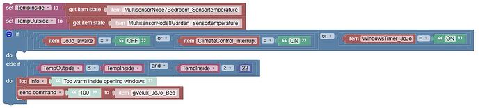

In Blockly, create a variable and then set item.state to that variable. Then you can do conditional statements such as below
So far I have this (a few more else if need to be added). Can I just leave the first “do” blank?
Yes, you can but I would reconsider the logic. In order to access the second if statement, all conditions in the first loop need to be false. If that is the case, then I would use AND statement and the opposite values of each variable in order to enter the loop. You can then do another loop for the second condition.
Thanks, that makes a lot of sense. It is working now.
