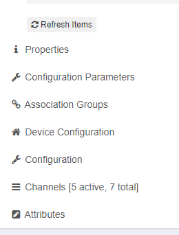

Thanks for the info! How do i adjust this parameter?
The usual way through HABmin or PaperUI, select your Thing and change it:
I checked both PaperUI and HABMin and parameter 6 in in neither location unfortunately.
It looks like the config parameters were added recently (January 11).
Perhaps the version of the binding in 2.5 stable doesn’t include those changes. Or, if you added those devices before upgrading to 2.5, maybe you need to delete and rediscover those devices.
