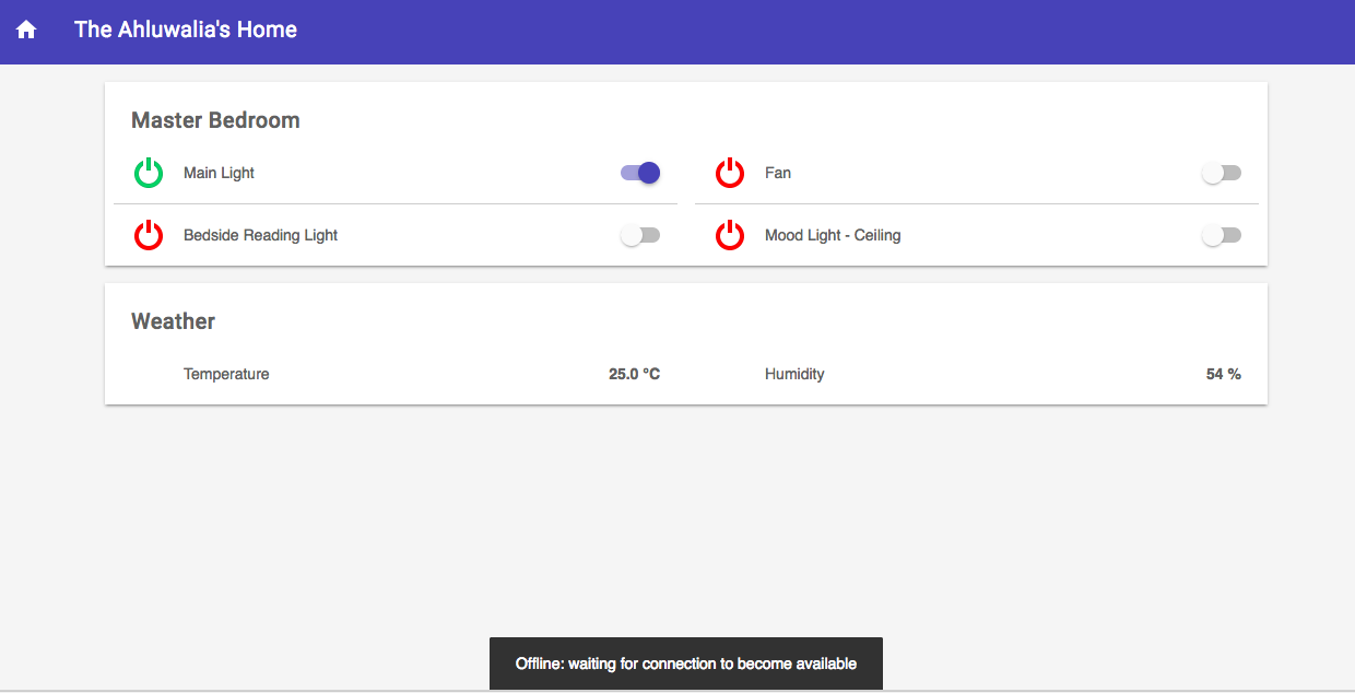

Got Yahoo weather i can get the temperature on Classic UI but the same is not visible on habpanel or app any ideas what i need to do for the same
Whenever i turn a device on or off i get the offline message in the bottom only happens in this UI
