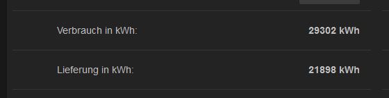

I have several electricity meters that I can query via knx. For example, my main meter supplies two values (electricity supply and electricity purchase), each of which supplies the values to openhab (2.5.0) via a type number channel. Now I would like to send these values to several mail recipients at certain times (e.g. every first of the month - 00:00 a.m.). I have already installed the new mail-binding and configured an smtp server using a things file. I haven’t worked with rules yet, so I don’t know what a suitable rule should look like. Maybe someone from the community can give me a little help.

In Basic Ui it looks like this:
