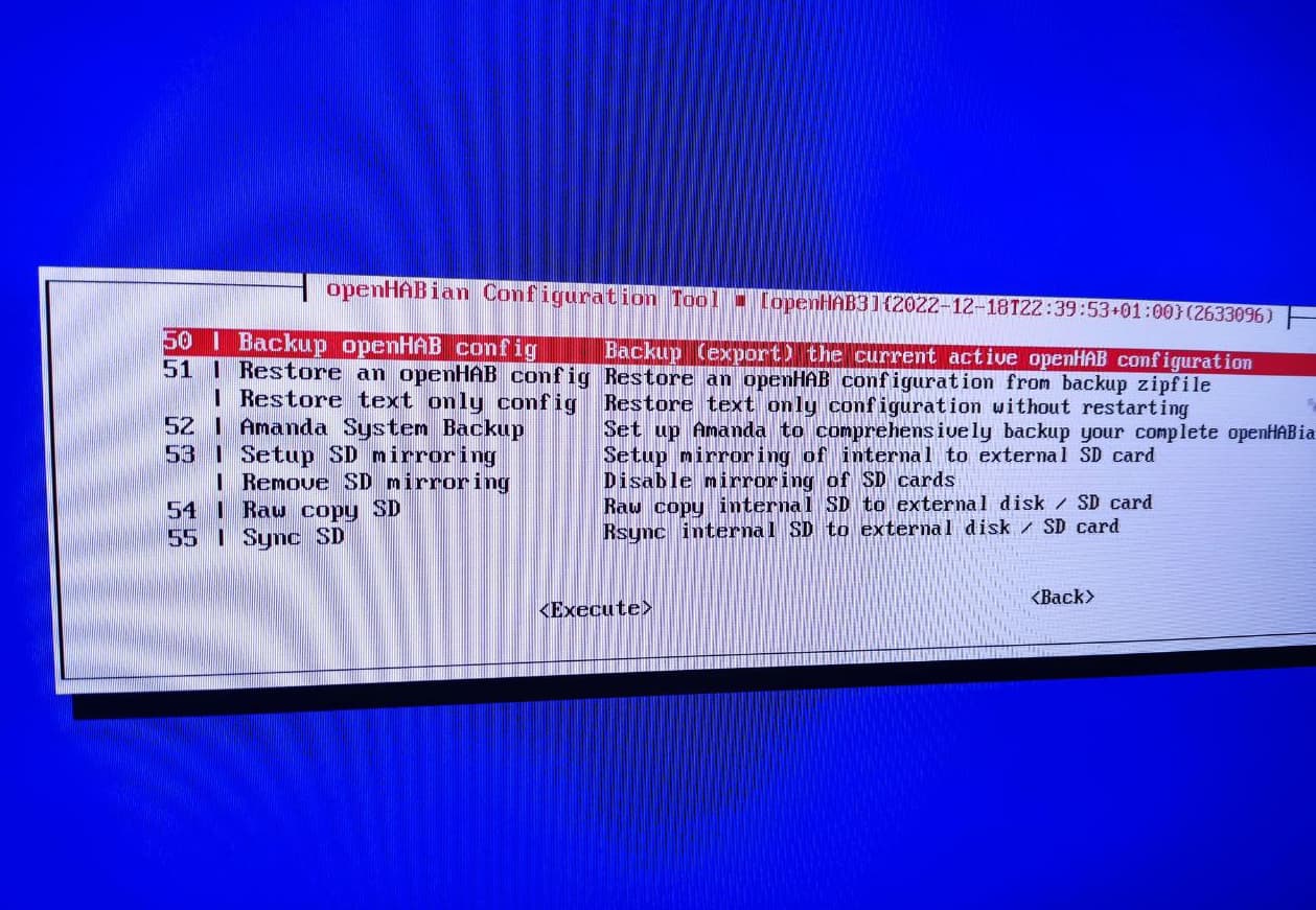

i already start OH3(update balenaEtcher to a new version, re-download OH3 and rewrite it again to sdcard) now OH starts correctly. Here is a picture with the selected menu that I use to do backups before the update.

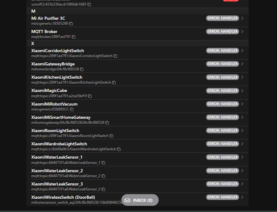

I recover some of my stuff but all zigbee2mqtt devices do not work, I install mosquito and zigbee2mqtt from openhub menu but what also do I need to do to run up my devices?
Next, I can’t install any binding, and then I try delete the corrupted file (openhab-addons-3.4.0.kar) from the addon directory, and somehow my Zigbee device was set to online (maybe MQTT Brocker also doesn’t want installs), but they still did not work because maybe need to add them to zigbee2mqtt list first. Will do it by hand.

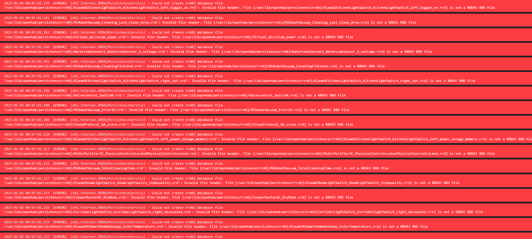

also, i have an error, try to look around but don’t understand what I need to do to fix it(try fix permission didn’t help)
