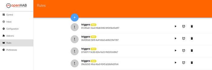

I use the Experimental Rules Engine with JSR223-Jython. I’ve never tried creating rules through Paper UI, but it looks like some triggers that I’ve created may be showing up…

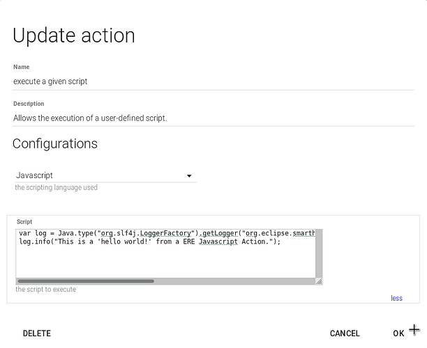

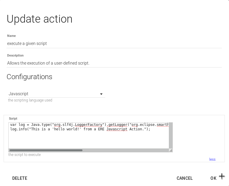

You mean in the UI? I just took a quick look, and I think I see what you mean. Putting in an Action to run a script, I don’t see anything in the dropdown or a way to link a file, but putting a script in the box worked…
The script was…
var log = Java.type("org.slf4j.LoggerFactory").getLogger("org.eclipse.smarthome.automation.module.script.rulesupport.internal.shared.SimpleRule");
log.info("This is a 'hello world!' from a ERE Javascript Action.");
2018-09-19 02:06:57.509 [DEBUG] [org.eclipse.smarthome.automation.core.internal.RuleEngineImpl] - The trigger '1' of rule 'ccb02c96-6d3f-414b-a060-c46994cc13e2' is triggered.
2018-09-19 02:06:57.515 [INFO ] [org.eclipse.smarthome.automation.module.script.rulesupport.internal.shared.SimpleRule] - This is a 'hello world!' from a ERE Javascript Action.
I assume the JS could just read from a script file. I can also select a ‘run rules’ action, and chose one of my Jython rules. Unfortunately, they are all named the same thing, but I’m currently working on a massive change to the Jython triggers.py module that will hopefully correct that.

I could find no way to load a JS from a file short of copy and paste.
The lack of documentation makes it really difficult to guess how all the parts interact with each other. But if I can call JSR223 rules but set up the triggers using the Experimental Rules Engine, that would go a long way towards making the ERE more useful in the near term since the missing pieces (i.e. logging and ability to call Actions) will be available in Jython et. al. even if they are not available to the JS entered in the Script text box in PaperUI.
I don’t think there are missing pieces… just a lack of documentation! The example JS script I used had logging, and I don’t see why you couldn’t use Actions in the script. I use them in Jython. I’ll circle back to UI ERE in a bit with a more involved example and writeup. Also, you can create a UI ERE rule without triggers, and execute it from another rule. And there are templates!
