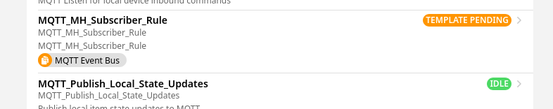

Regarding the MQTT Event Bus … I like the concept and have already tried to use it. Clearly I’m doing something wrong, however, as I never get past “Template Pending”. It’s been pending for days now.

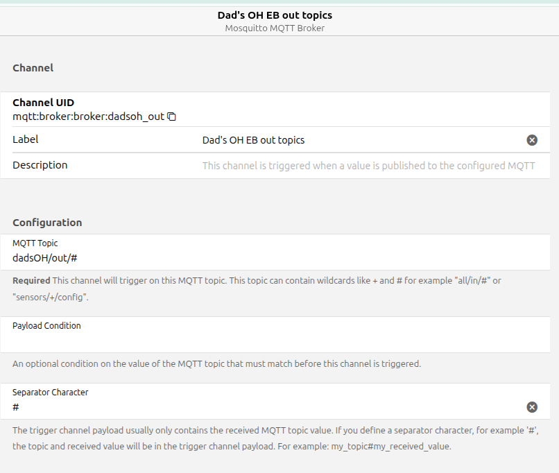

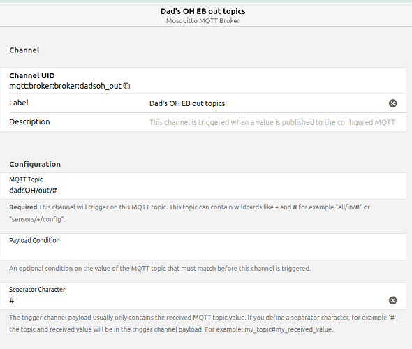

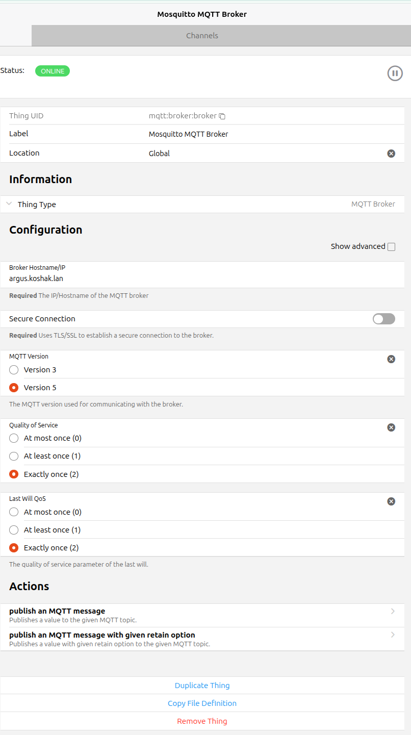

  1. Open the MQTT Broker Thing
  1. Open the Channels tab and click “add channel”. Fill in the form giving it a name. There’s only one type of Channel type to choose.
  2. Fill out the subscription. Usually this will be a wild card subscription. The “separator charactor” field will be the character inserted between the topic and the message in the event that gets sent to the rule.
  1. Create a rule. Add a “Thing Event” trigger and select the Channel you created in 3.

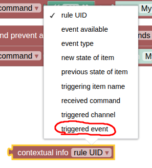

  2. The topic and message is passed into the rule as part of the event. How to get that depends on the rules’ language you are using. In Rules DSL it’s receivedEvent.
    In Blockly it’s under Run & Process in the context info block.
    In JS it’s part of the event Object (or if on OH 5.1 with the wrapper enabled or are using file based JS rules see this). Note the docs are not complete for the UI event Object. You need to access it with event.event.
  3. In all of these cases, receivedEvent, the contextual info block, event.event or event.receivedEvent will be a String consisting of <mqtt topic><separator character><received message>. For example, given the screen shot from above event.event might be something like dadsOH/out/LivingroomLight#ON.

I’ve never seen “Template Pending” anywhere before. You see this where and when? When installing the template? When trying to instantiate a rule using the template?
Thank you. I’ll go through the process again following your excellent detailed instructions.
Regarding “Template Pending”, it appears on the Rules list. If I open the rule, it says “Uninitialized”. The rule looks like I filled in everything, but obviously something is amiss. I expect that when I follow your instructions, that issue will be resolved, so this is really just FYI.
When and how did you install the template? Where there any errors in the log when you installed it and/or when you created the rule based off the template? When there is no error creating a rule from a template should take no time at all. What ever is going on here is an error of some sort.
I would go to the Add-on store, remove the template and then readd it, watching the logs for errors.
Then return to the Rule and click “Regenerate” to recreate the rule based on the newly installed tempalte.

Regarding the “Template Pending” … I’m sorry I didn’t make that clear in my prior response. “Template Pending” was apparently caused by my not filling out all the fields. I’d failed to fill in the broker (because it visually looked to me like it was auto-filled when it was really just a hint), the update group, and another field that eludes me now. Once I filled those in correctly and regenerated, the “Template Pending” issue disappeared. That may be an issue from your perspective, but it makes sense to me as a user now. It would be nice if those errors were reported back through the UI instead of in the log, but that’s probably easier said than done.
OK, that explains the pending issue then. All required fields must be filled in and for that rule template all fields are required.
