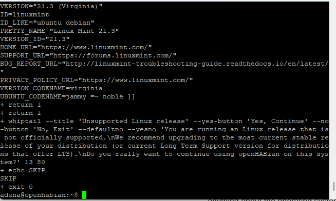

I am not at all unhappy with Mint. But Openhab config is fussing about the release (i brought Mint current) and says it is not supported and I should therefore not continue. This worried me…hence the move to Debian which it recommended. This is running on a standalone laptop. Nothing is wrong, just trying to stay current.

Show the message you are seeing. I’m unaware of any checks anywhere in openHAB that cares anything about the operating system you are running.
However, if you are running openHABian (which may or may not work well, it’s known not to work well with Ubuntu) I would expect you might see a message like that.
More importantly though, OH 5 requires a 64-bit operating system mainly because there are no official builds of Java 21 for 32-bit operating systems. If you are in fact running a 32-bit operating system, you will have to reinstall the OS to upgrade.
I confirmed it is 64 bit
OK, so this message is in deed coming from openHABian and not openHAB. It’s important to understand the difference.

Your error message is coming from openHABian and yes, openHABian is known not to work with Ubuntu. Since Mint is downstream from Ubuntu it’s not surprising that openHABian doesn’t work with it too. But that doesn’t mean openHAB doesn’t work. It’s just these convenience scripts in openHABian that do not work.
So your choice is to abandon openHABian which means you’ll need to manually do most of the work setting up and updating your system or reinstall everything from the operating system on up using64-bit Debian as the base, then installing openHABian using the manual instructions, and finally restoring your backed up configs from your current Mint install.
