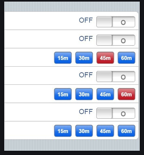

i want to use a items for my rollershutters, like this
if the buttons are pressed for up, down or stop I get up and stop a 0 and down 100.
The output of the percentages 0 or 100 I find unhelpful, since the stop command completely goes down here.
Better would be an output of the commands ‘high’, ‘down’ or ‘stop’.
In the forum I find some sitemap examples where several buttons are assigned. Unfortunately I can not find the right code for items and sitemaps.
Can someone please help me the appropriate syntax for a switch with 3 buttons indicate or show where I find it.

Those are a Switch with mappings. https://www.openhab.org/docs/configuration/sitemaps.html#mappings
There is something to note here that is important. UP, DOWN, and STOP are commands, not states. Your Item on the sitemap will never show a state of “UP”, for example. The Rollershutter’s state will only ever be a PercentType (number between 0 and 100). So in the Item lable (e.g “South window [%s]”) will only ever show “South window 57” or whatever number the Item’s state is in.
