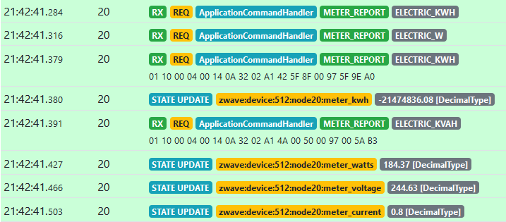

From what I understand the unit is sending the wrong info. Looking at it is reporting the total usage Max converting it to a negative and then adding on the acutual (hope that makes sence).
As such looks like a firmware issue to me on Neocool side.
I don’t think you can quite make that assumption - let me rephrase what you’re (nearly) saying. Instead of saying the unit is sending the wrong info, which we don’t know for sure, we can however say the controller is receiving the wrong info…
I expect this is actually caused simplly by corruption of data over the RF link - this isn’t uncommon for ZWave as the standard error detection is pretty poor. Newer devices may incorporate secondary encapsulation to resolve this, but it’s still not supper common.

To update I moved the unit next to the controller and allowed a network heal to happen. I have noted the device has a direct connection to the controller. Since then I have seen incorrect figures received.
Chris, although there is a direct connection, is there a way to confirm wave issues or are we now saying buggy kit.
I had RF problems with the NEO Coolcam Z-Wave Plus Smart Power Plug. I have taken the plug apart and observed a really poor antenna design. This could be a similar issue.
Yes stacks up with what I seeing. Strange as the watts live is always reporting correct.
I’ll just put this down to bad kit.
