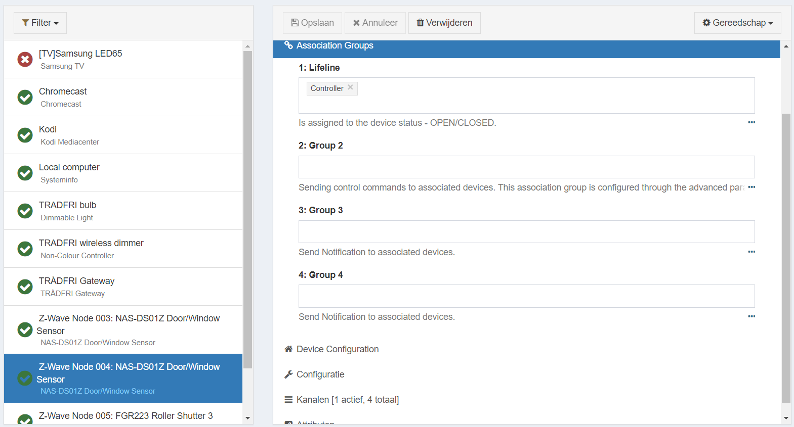

Laura and I are doing this together so I can answer as well. We did try HABmin too for configuration. I guess we need to assign the controller to the first association group. When we try to do that, it looks like it is saving but when refreshing the page, the controller disappears. This is what the log says when saving:
2019-04-11 08:07:06.902 [me.event.ThingUpdatedEvent] - Thing 'zwave:device:4ff1d057:node2' has been updated.
2019-04-11 08:07:06.909 [vent.ConfigStatusInfoEvent] - ConfigStatusInfo [configStatusMessages=[]]
So the problem is, it is not saving the association group properly. Is there anything what we don’t know that needs to be done?
Thanks again!
There is a display bug in HABmin. Even it is not visible it should be fine:
If we refresh it disappears again.
Check the log when you save the configuration. It should notice in the log that the device has updated. Habmin should tell as well (success update).
If log is okay, then ignore habmin´s display bug.. It´s a really annoying bug, which has confused alot of people. You can check the settings in PaperUI as well.
Your sensor should be good to go, (unless the sensor is faulty ofcouse).
