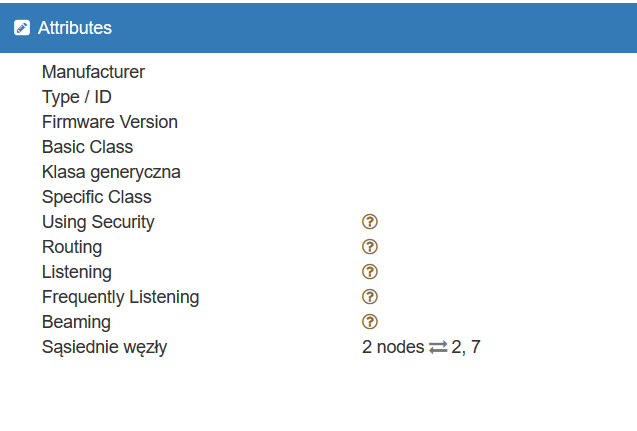

Will try that for sure. Just from pure curiosity is it normal for Z-Wave controller (in my case RaZZberry) that is showing no info in controller thing under Attributes?
It must be normal. I think that area is mainly designed for normal devices.
