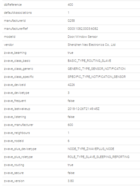

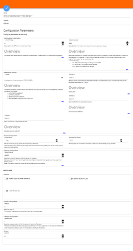

Ok, just to confirm, can you look in PaperUI in the properties for the device, and you should see something like dbReference - can you quote those numbers.
Looking at the door sensor, I will make a change to the database to change the channels type as the alarm type is wrong and won’t work properly I’ve not looked at the PIR yet, but will check once you confirm these references.

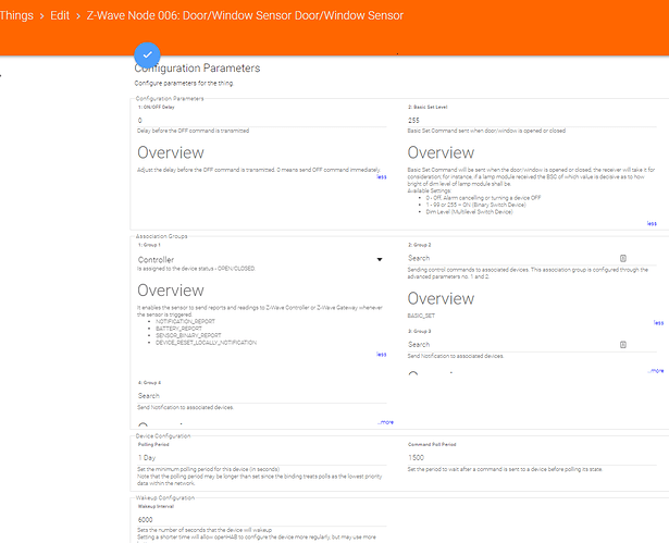

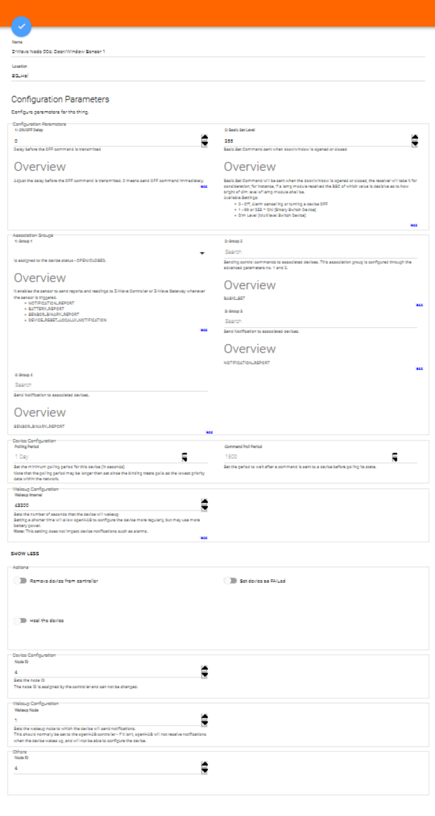

I am sorry but i can’t find a dbRefference in PaperUI or something that looks like that in the propperties.
I beleve this screen is the propperties of the device…
But if that’s not the case, can you please tell me where to look for this?
Or maybe there is a way via the Karaf console?
No - this isn’t the properties - this is the configuration. In the previous page (ie the main thing page which also shows the channels) there should be a properties list.
I’m sorry, but i can’t see a propperties button or menu item… This is my Items main screen:
I am searching the docs to find this dbRefference.
This is the things list - I meant the main page of a specific thing…
Don’t worry - I think I can work it out from other information.
This is not documented in the user documentation as it’s a low level bit of information, but you should find it in the properties list of the device along with all the other device properties.

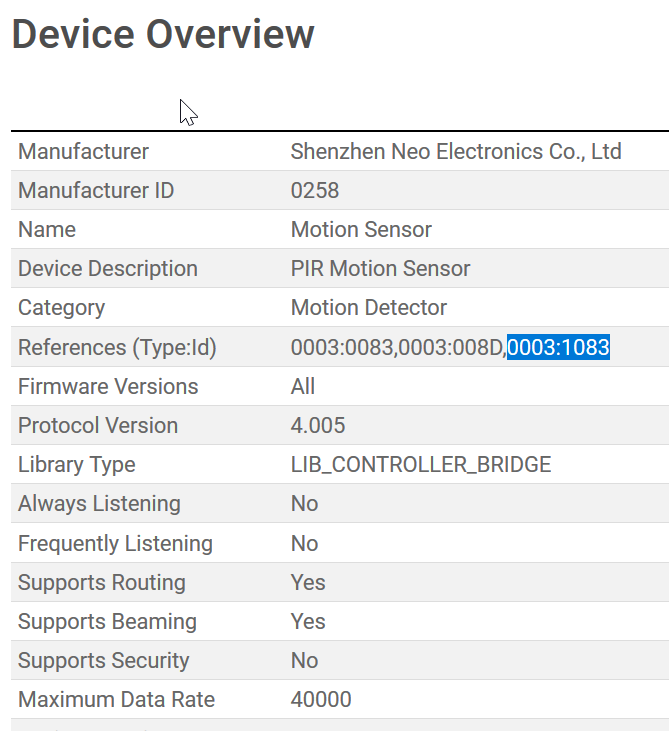

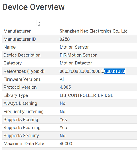

I am looking at the node5.xml en find these parameters:
<manufacturer>0x258</manufacturer>
<deviceId>0x1083</deviceId>
<deviceType>0x3</deviceType>

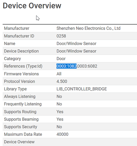

When i look in your online database then these correspond with this device: Shenzhen Neo Electronics Co., Ltd - 0003:1083
Would that be the info you needed? If so, i will find the Door/Window Sensor also.

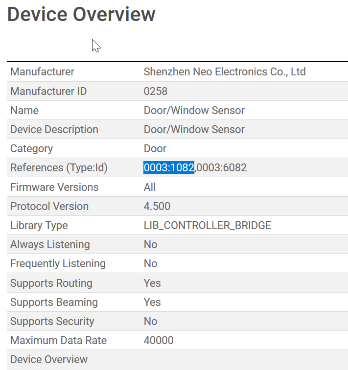

For the Door/Window Sensor i found thisin de .xml file:
<deviceId>0x1082</deviceId>
And in your on-line database it corresponds with this one Door/Window sensor - 0003:1082

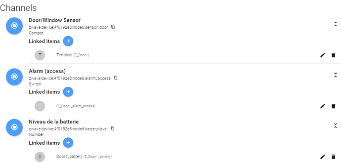

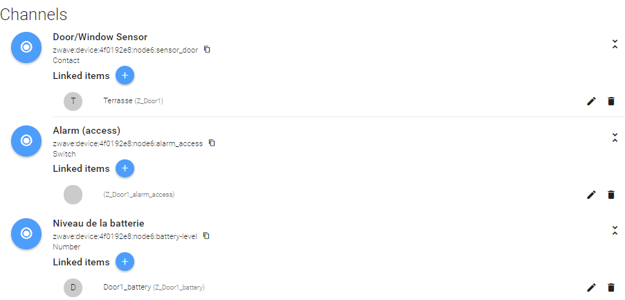

Further testing, i created second items by one of the Door/Window Sensors and chose “Create new item…” and let the system decide the name.
By the Things definition, in the Channel for the Door/Window Contact the item is a Contact type. Unclear to me is whether i have to use Contact or Switch in the sitmap file. I’ve read some contradictory things about the Contact type… But i tried both, without success.

My Neo Door Sensor is in online but the Openhab items are not updated.
it worked in the past, on 2.3
i can open and close the door. The items are not updated.
My configuration:
RASPBERRY PI 3 MODEL B+
openHAB 2.4.0 Release Build
Controller: Aeon Labs Z-Stick - USB Adapter with Battery GEN 5
NEO Coolcam NAS-DS01Z Smart Home Z-Wave Plus Door Window Sensor Compatible with Z-wave 300 series and 500 series Home Automation
What i have done till now:
I have deleted the thing.
i have excluded
i have reincluded but it do not help
My items are well linked
The thing configuration:
The items properties:
https://www.cd-jackson.com/index.php/zwave/zwave-device-database/zwave-device-list/devicesummary/400
Any Ideas?
