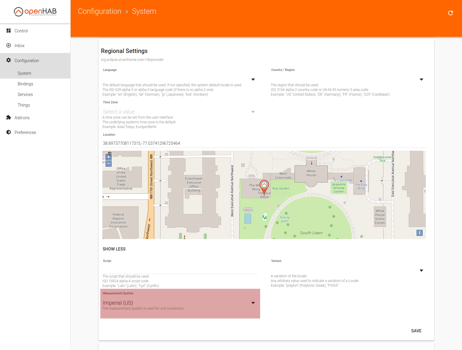

In 2.3.0-SNAPSHOT you also need to set the measurement system to “Imperial” via Paper UI > Configuration > Regional Settings > Show more

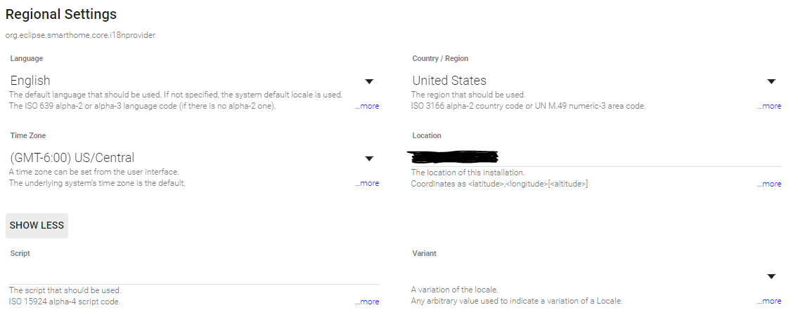

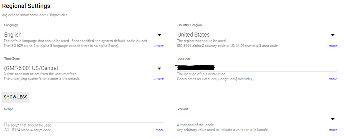

I don’t see this option for Imperial unit of measurement in PaperUI. Here is what I have in my 2.3.0-SNAPSHOT:
Also, I’m not sure if I’m overlooking something, but after removing the old items file, the old channel names (“NestTStatFamilyRoom_whatever”) are still displaying in PaperUI and Habpanel. The new “Thermostat_” names that I copied from the link you provided don’t appear in any dropdown lists. There seem to be so many things that aren’t lining up, it’s hard to focus on one thing.
It doesn’t look like you are using a recent 2.3.0-SNAPSHOT version @keithm . This is what the “Regional Settings” section should look like on recent builds:
@wborn Thanks for your continued guidance on this. It’s much appreciated. So after consideration, I set up a brand new instance of the 2.3.0-SNAPSHOT and restarted from scratch. The flow seems to be better in this release. I’m also able to set the unit of measurement to Imperial here.

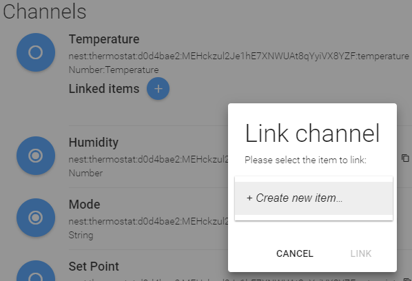

OH discovered the Home, Nest Account, and Thermostat Things no problem; and getting them online went smoothly. The problem I’m running into now is linking channels… specifically the temperature channel. When I linked Humidity and Mode, I was able to select the appropriate variable from the dropdown. But I’m having a problem with the Temperature channel. It doesn’t seem to find anything:

If you are on 2.3 SNAPSHOT, the Temperature channel of the nest wants a item of type Number:Temperature. It’s a new type of number that include the units.
So change your item definition to:
Number:Temperature Nest_Temp ......
And the item should be available in your dropdown to select

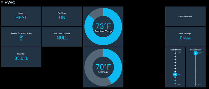

@wborn Thank you for the updated items example. Ambient temperature, set point, humidity, min/max set points are all working now!! Forward progress!

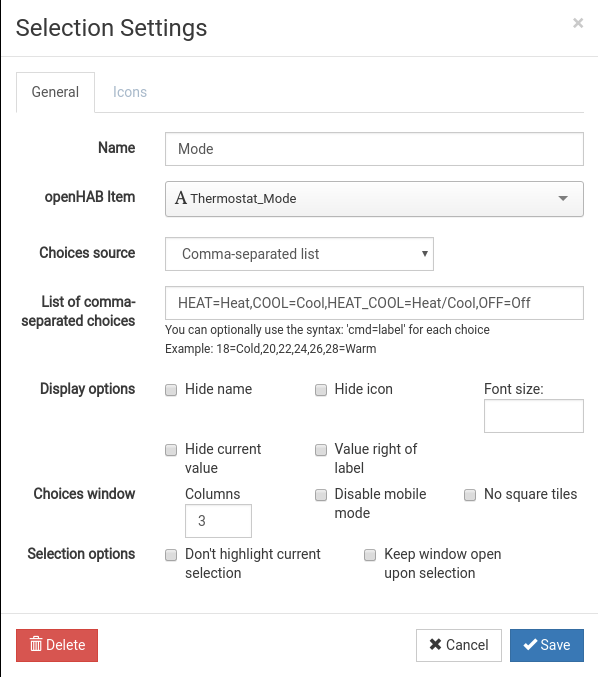

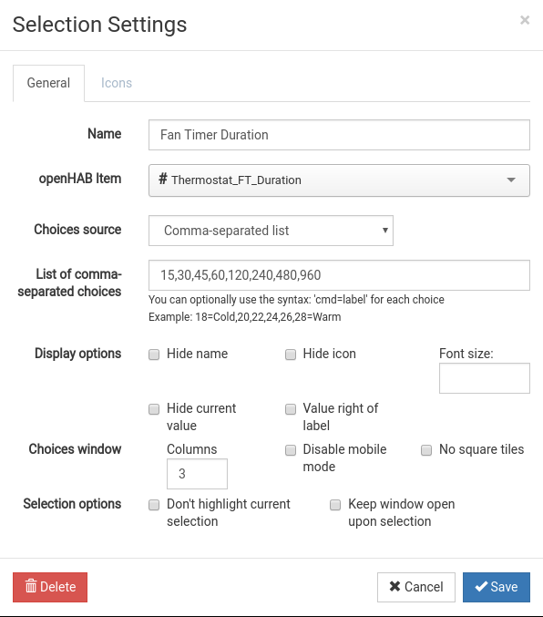

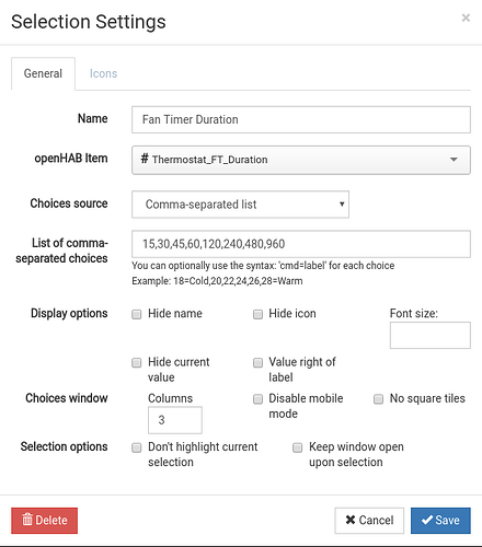

Two things I noticed that don’t work though are the mode and fan timer switches. Both return “No choices available - check widget config.” These are both using the Selection widget. Is that the correct widget to use in this case?
It should be possible for the selection widget to get the HVAC mode values. But it seems to fail for some reason.
I got both working by providing comma separated values with a selection widget:
