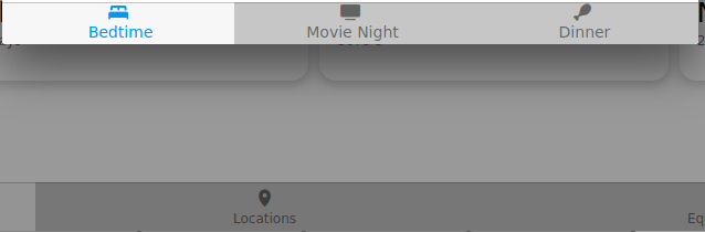

I was exploring the tabbed pages for a hierachical control setup, and tried to have a tabbed page in a tabbed page. This did not work from the usage side.
You can set it up, but the page remains empty.
Is that by design, technical limitation or a bug?
OK, I’m not too surprised that trying to put a tabbed page in another doesn’t work. As I understand it, the f7 tab bar isn’t at the bottom of a container like a page, it’s defined as being either at the top or the bottom of the app. This means that if you try to define a page with a tab bar at the bottom and then put another page that defines a tab bar at the bottom you run into a conflict instead of the tab bars just stacking on top of each other.
It is possible to define a tab bar as being at the top of the app as well, and you can have both a top and a bottom tab bar simultaneously, but the tab-page tab bar is hard coded to be at the bottom so there’s just no way to achieve this using basic pages alone.
If you really have your heart set on using this style of navigation, then you will probably have to build most of this from scratch as a custom widget and set one of the tab bars at the top and the second at the bottom of the widget.
If you are interested, you can have modal dialogs popup with their own tab bar even on a page that already has a tab bar (I guess the modal window counts as a new app space), but again, the popup is a custom built widget.
