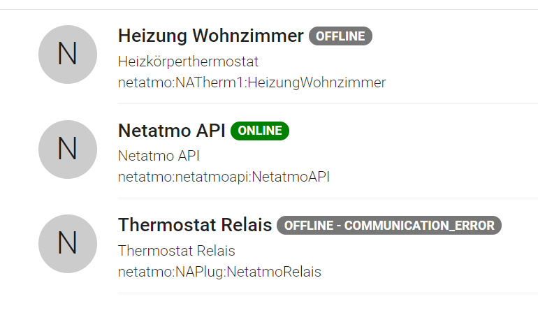

Hello, I also have problems with the binding. I can create the “bridge”, but unfortunately that’s it.
The relay does not connect to the API and accordingly the thermostat remains offline.
Does anyone have any idea what’s going on?
I have installed openHAB 2.5.10 but the problem has been around since version 2.5.9.
The answer is simple there: current binding does not support thermostat/relais,
Aha, but that could also be mentioned in the documentation.
I bought the Netatmo devices especially because the documentation says that everything is supported. Not cool!
Recent thermostat devices are no more supported because the Netatmo API fully changed for these devices.
Old devices are still supported.
