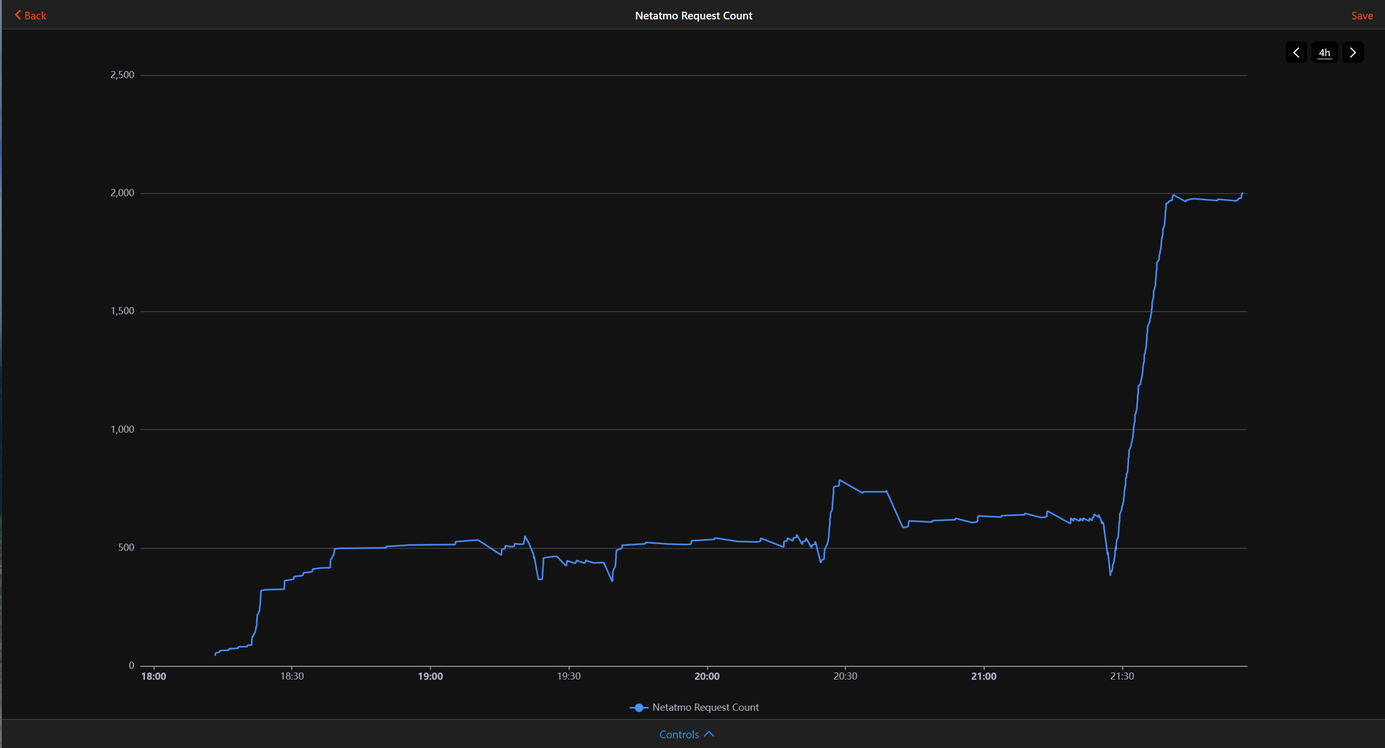

I have the same issue. I am using v4.0.2 but it started with v4.0.0
After the upgrade from 3.x to 4.0.0 the issues started. The binding has flooded the netatmo server.
It seems that the binding is trying to find the best time to get newest data. It does it by simple trying it. Weird. In the data are update timestamps which could be used instead.
The problem is the interval of this initial requests get immediately reset if you have a second weather station (own weather station and a favorite weather station) and it also try to find the best time. After that the flooding begins.
I have removed the netatmo config and uninstalled the binding. Re-installed the binding and slowly added the config (waited until the first station is up). Everything was fine for some weeks until today.
The binding flooding the netatmo server again.

Another thing. Why is there a separate request for min/max per day? This information is already in the basic data. As long there is no other scale than 1day an extra request should not be needed. Especially if the request count is limited!
On the Netatmo API there is a monitoring channel (request-count) that you can link to an item in order to measure requests evolution over time.
If you’ve got the feeling that it may be a bug (that apprently look like it) feel free to file an issue in github.
Also, those facing this issue all have multiple weather stations (including guests) or a single one ?
Thanks for the info about the request count.
Yes, I think this is over the 500 hourly limit.
Or during the night.
Before midnight I have disabled the thing for the favorite station. You see a short reduction afterwards.

When the api limit is reached the binding does not slow down its requests.
For reestablishing the normal connection I found a ā€œbetterā€ method:
Disable the things with measurement channels, restart openhab, wait one hour, enable the things with measurement channels.
