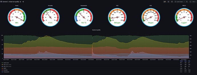

I am using Awair element air quality monitoring. It does co2 and a few other things too. I posted how to use it with openhab if you search. It uses local API and there is a phone app.

T, RH, CO2, VOC, PM2.5
It doesn’t need cloud access but it is in an option. It seems sensitive and can quickly detect people in the room by an increase in CO2. I used it to check and set the air flow levels for my house which has a managed filtered air supply. VOC will detect easilly perfume spray and other things. As can be seen from the spike below.
