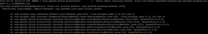

Hi Gaël,
Hope you’re fine ?
I have Openhabian 2.5 .
I add the new binding
org.openhab.binding.netatmo-3.1.0-SNAPSHOT.jar
inside the
/usr/share/openhab2/addons
and i meet an issue, see the log bellow
Do you have an idea to solve this ?
Best regards,
Louis
