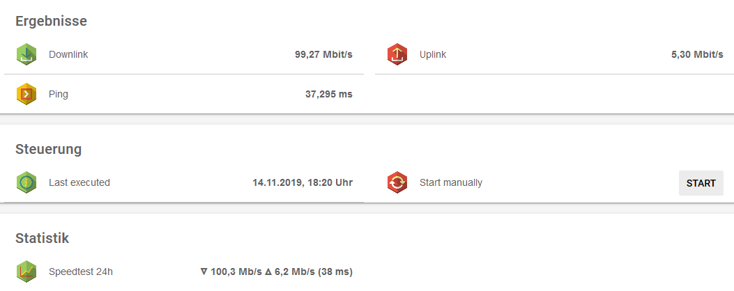

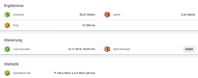

Same here and it is working.
But I am using PaperUI Network binding Things, so I guess you should start looking in your things file.

I think I was on the wrong track: I just compared the first line from the first post
String Speedtest_Running "Test running ... [%s]"
with the speedtest example from here which I am using:
and that item is almost :sunglasses: the same:
String SpeedtestRunning "Speedtest running ... [%s]" <"speedtest_new"> (gSpeedtest)
Sorry for the confusion.
BTW, the linked speedtest tutorial and example is working great :grinning:
