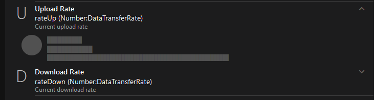

Where did you do that? I’m trying to avoid file configs with OH3 now. So I checked the possibilities when linking the item and see that “Number:DataTransferRate” is the preset.
grafik
I tried changing this to “String”, but still get the same error. Presumably since the channel in the binding is already defined as such:
So I guess, I have to fall back to create this thing as a Textfile Item to resolve that problem :-/ ?
