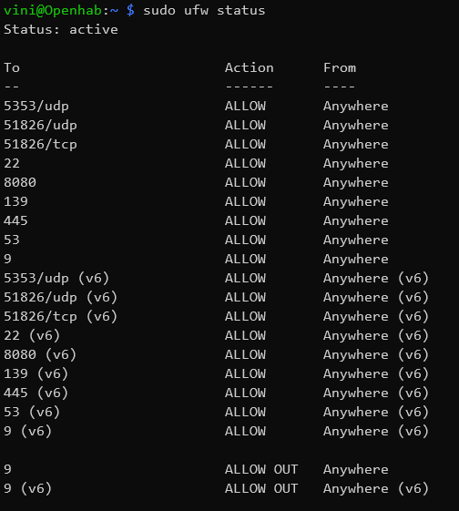

I did recently install UFW and wondered if I’d broken the firewall config on the Pi on which I have OH running. Checking UFW Status revealed Port 9 wasn’t open, so I opened that (in/out) and still no joy.
I then installed etherwake on the Pi to test functionality/comms from the Pi itself, and running etherwake to initiate the magic packet does work.
Unless I’m mistaken, this points to OpenHab as being the issue.
