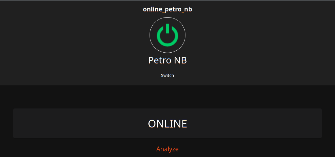

Problem is that user has no permission for socket for ping, what is used by Openhab in official container. Issue can be fixed in runtime by calling
setcap cap_net_raw+ep /bin/ping
, before running Openhab. Bundle performs test once at startup and then uses result.
I am building my own docker image on base of official to add some extra there, so it was easy to fix, i have committed it here: Fix Openhab ping command usage under Proxmox LXC for network:pingdevi… · petrows/saltstack-config@a0c332e · GitHub
Now it works, hope it will help! I have device with proper online status, for example for Laptop what i am using right now:
