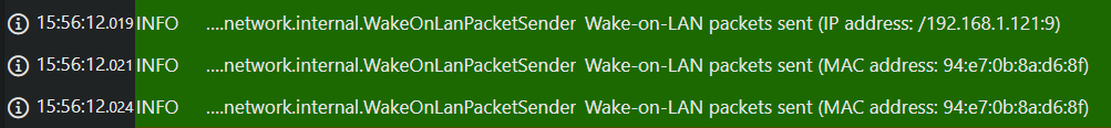

Just ‘upgraded’ from OH 4.1.0 to latest 5.1.1 by way of a fresh micro-SD image of latest openhabian (x64). Took a backup of config via openhabian menu beforehand, imported it into the new system via same method. I do not believe my problem is related to that process.
However, WOL with the Network binding was working for me previously and is definitely not any longer.
I have a virtual switch item defined and a rule that is set to watch for the ON command. When ON is received, the rule runs a script to send a WOL packet.
In the binding documentation, I see the old method
sendWakeOnLanPacket()
has been deprecated. I have updated my rule with the updated methods. I have tried singling out the new/old methods in my rule (as to only use 1). Currently, I have all 3 methods in the rule. I can see in the new Log Viewer (which is really nice, thank you devs!) that the WOL packets are being sent - regardless of the new or old or multiple methods in use (with all 3 in the rule, I see 3 OK entries).
So, I am kind of lost at this point, if anyone could help guide me..
Additional notes: openhab is in a different subnet than target WOL device. This was never a problem in the past. Unifi network equipment in place, rulesets have not changed, permits seen in syslogs. Added addtional, more permissive rules for argument’s sake, no change.

      script: |-
        val actions = getActions("network", "network:pingdevice:602e77db80")
        if (actions === null) {
            logInfo("actions", "Actions not found, check thing ID")
            return
        } else {
            // Send via IP address
            actions.sendWakeOnLanPacketViaIp()
            // Send via MAC address
            actions.sendWakeOnLanPacketViaMac()
            // OG but deprecated
            actions.sendWakeOnLanPacket()
    type: script.ScriptAction
log viewer:
