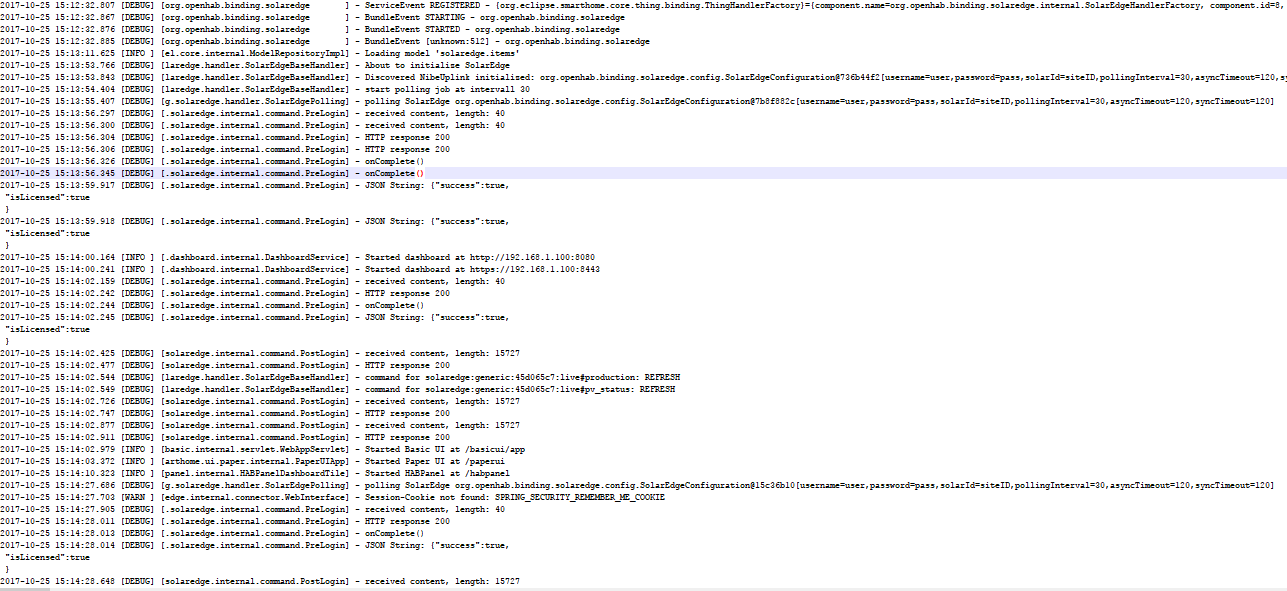

Hi, sorry I
am not able to upload the log file.
So, I copy the text below and I upload a screenshot.
Thanks again for your help.

Hi Javier,
it seems your setup only returns one value:
2017-10-25 15:14:29.027 [DEBUG] [internal.command.AggregateDataUpdate] - JSON String: {“fieldStartDate”:1448123428000,“fieldEndDate”:1508975999000,“dataStartDate”:1508889600000,“dataEndDate”:1508975999000,“utilizationMeasures”:{“production”:{“value”:8.557,“unit”:“KWh”}}
“aggregate day production”. I do not know why there are no other values, at least export/import should also be available even if not battery is installed.
The live data string is empty - however:
2017-10-25 15:14:28.948 [DEBUG] [edge.internal.command.LiveDataUpdate] - JSON String: {“siteCurrentPowerFlow”:{}}
