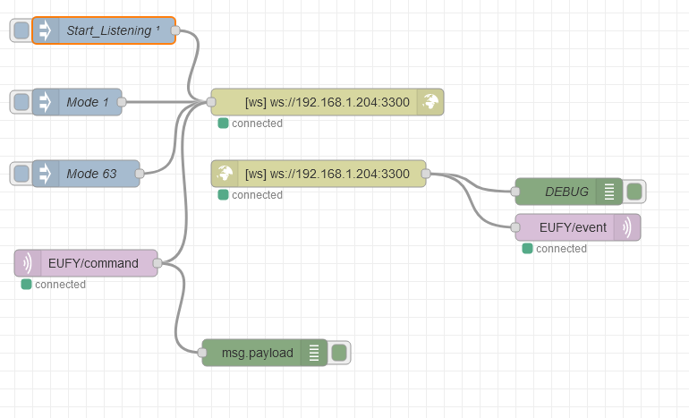

Finally, I use this docker to connect to the Eufy API
With Nodered to create the link between the websocket above and openhab.
Works fine so far. Let’s see if its stable
(I already have my alarm connected to openhab. The goal was to activate/deactive the camera movement detection depending on my alarm system, and to receive the alerts in openhab to trigger my alarm)
This is fantastic, any luck getting it to show camera live on openhab?
Surprisingly, it is very stable. It never failed for 2 weeks now.
The pushed notification have almost no delay.
It don’t use the livestream, and didn’t test it.
However i use the PictureURL property wich is a link to jpeg on an amazon cloud file, and it works fine (it’s the picture you see on the android app, taken when the last event was triggered).
It works so well I ordered to new cameras to complete my setup.
Below you’ll find the 2 docker-compose for both eufy-webservice and nodered, and the nodered flow.
The nodered flow receives commands from MQTT and sends event via MQTT also.
Two hints: you need to create a secondary eufy account for the websocket docker, and the correct format for the payload is {“command”: “start_listening”, “messageId”: “start_listening”}

NodeRed Flow
[{"id":"cd2b76ff.67e048","type":"tab","label":"EUFY","disabled":false,"info":""},{"id":"1b8c84a6.252b2b","type":"debug","z":"cd2b76ff.67e048","name":"DEBUG","active":true,"tosidebar":true,"console":false,"tostatus":false,"complete":"payload","targetType":"msg","statusVal":"","statusType":"auto","x":640,"y":300,"wires":[]},{"id":"90e18b5.e3ae378","type":"websocket in","z":"cd2b76ff.67e048","name":"","server":"","client":"5a1f1b78.b358e4","x":360,"y":280,"wires":[["1b8c84a6.252b2b","dbfb2bd.8d2ba58"]]},{"id":"cde7f6c2.85aeb8","type":"websocket out","z":"cd2b76ff.67e048","name":"","server":"","client":"5a1f1b78.b358e4","x":370,"y":200,"wires":[]},{"id":"bca3980.2d2b8e8","type":"inject","z":"cd2b76ff.67e048","name":"Start_Listening","props":[{"p":"payload"},{"p":"topic","vt":"str"}],"repeat":"","crontab":"","once":true,"onceDelay":"30","topic":"","payload":"{\"command\": \"start_listening\", \"messageId\": \"start_listening\"}","payloadType":"str","x":120,"y":120,"wires":[["cde7f6c2.85aeb8"]]},{"id":"2560c7a9.4dc948","type":"inject","z":"cd2b76ff.67e048","name":"Mode 1","props":[{"p":"payload"},{"p":"topic","vt":"str"}],"repeat":"","crontab":"","once":false,"onceDelay":0.1,"topic":"","payload":"{\"command\": \"station.set_guard_mode\", \"messageId\": \"set_guard_mode\", \"serialNumber\": \"T8010N2321061E81\",\"mode\":1 }","payloadType":"str","x":90,"y":200,"wires":[["cde7f6c2.85aeb8"]]},{"id":"99a9e07f.5d9608","type":"inject","z":"cd2b76ff.67e048","name":"Mode 63","props":[{"p":"payload"},{"p":"topic","vt":"str"}],"repeat":"","crontab":"","once":false,"onceDelay":0.1,"topic":"","payload":"{\"command\": \"station.set_guard_mode\", \"messageId\": \"set_guard_mode\", \"serialNumber\": \"T8010N2321061E81\",\"mode\":63 }","payloadType":"str","x":100,"y":280,"wires":[["cde7f6c2.85aeb8"]]},{"id":"dbfb2bd.8d2ba58","type":"mqtt out","z":"cd2b76ff.67e048","name":"","topic":"EUFY/event","qos":"","retain":"","respTopic":"","contentType":"","userProps":"","correl":"","expiry":"","broker":"82d6b3db.6d576","x":650,"y":340,"wires":[]},{"id":"a42a0c32.be177","type":"mqtt in","z":"cd2b76ff.67e048","name":"","topic":"EUFY/command","qos":"2","datatype":"auto","broker":"82d6b3db.6d576","nl":false,"rap":true,"rh":0,"x":100,"y":380,"wires":[["cde7f6c2.85aeb8","15a2f24f.aa630e"]]},{"id":"15a2f24f.aa630e","type":"debug","z":"cd2b76ff.67e048","name":"","active":true,"tosidebar":true,"console":false,"tostatus":false,"complete":"false","statusVal":"","statusType":"auto","x":300,"y":480,"wires":[]},{"id":"5a1f1b78.b358e4","type":"websocket-client","z":"cd2b76ff.67e048","path":"ws://192.168.1.204:3300","tls":"","wholemsg":"false"},{"id":"82d6b3db.6d576","type":"mqtt-broker","name":"MQTT","broker":"192.168.1.220","port":"1883","clientid":"NodeRed","usetls":false,"protocolVersion":"4","keepalive":"60","cleansession":true,"birthTopic":"","birthQos":"0","birthPayload":"","birthMsg":{},"closeTopic":"","closeQos":"0","closePayload":"","closeMsg":{},"willTopic":"","willQos":"0","willPayload":"","willMsg":{},"sessionExpiry":""}]

@aymeric106 thanks for posting a workable solution. Does this solution enable the eufy doorbell / camera to work without the cloud / internet. In other words, does the docker connect to the eufy cloud or directly to the camera/doorbell?
