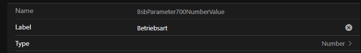

i have tested with parameter 700.
But i can’t set the parameter - what is the correct configuration for writing the parameter?
Parameter Set-ID ???
Message Type: INF or SET???
I should mention that I have flashed the BSB-LAN adapter in write mode and writing this parameter through webinterface of BSB-Lan works!
kind regards,
Stefan
thanks - in my setup I use SET (just tried it and it works for me), the thing configuration looks like this:
UID: bsblan:parameter:heating:p700
label: Betriebsart
thingTypeUID: bsblan:parameter
configuration:
  setType: SET
bridgeUID: bsblan:bridge:heating
It is linked to a “number value item”
via the number-value channel
with the following state description:
…I use a pretty old BSB-LAN version (BSB-LAN Web, Version 0.44.5-20200223082848), not sure if the API has changed on their side.

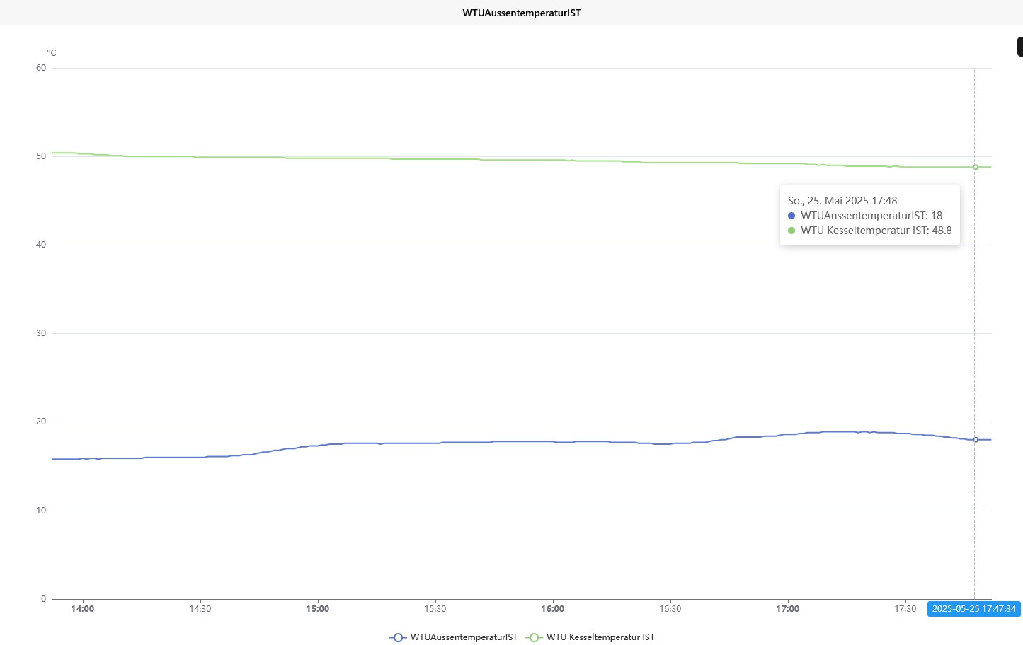

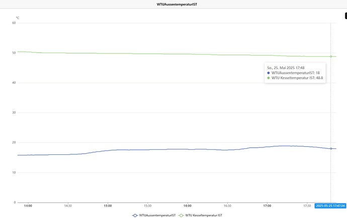

Hi everyone,
pretty quiet here. That’s a pity. I would have liked to have heard about the BSB Lan project earlier, then I would have reached my goal more quickly. Maybe this post will help to make the project a bit more visible.
I thought for too long that my Weishaupt WTU heating system was compatible with eBUS, but it’s not. It works with LPB Bus.
"BSB-LAN is a software/hardware solution for accessing the “Boiler-System-Bus” (BSB), the “Local-Process-Bus (LPB)” and the “Point-to-Point-Schnittstelle” (PPS)"
With the BSB-LAN adapter, I can read out my heating system very easily, change parameters and track measured values.
A list of compatible heaters can be found here: https://docs.bsb-lan.de/supported_heating_systems.html
Many thanks to all supporters.
