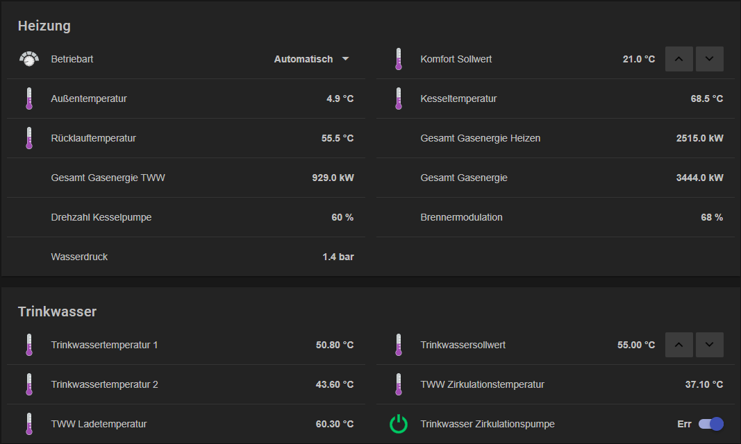

I did a very quick setup as I am short on time, but: amazing, works right out of the box, thanks for that :+1:
grafik
Will do some more tests during the next days.
Finally I had some more time to test in detail: reading and setting parameters for my heating system from Brötje works without any problems.
Great Job!

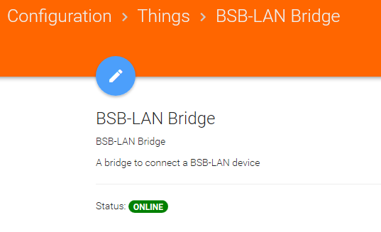

  • What status do the bridge and parameter things show in paper-ui?
    You should be able to see it via URLs similar to
    http://[ip]/paperui/index.html#/configuration/things/view/bsblan:bridge:heating
    http://[ip]/paperui/index.html#/configuration/things/view/bsblan:parameter:heating:p8730
    Here is how it looks in my system:

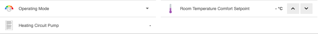

Now it looks like this.
Thank you
