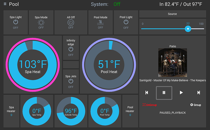

Screenshot of my pool control in Habpanel
