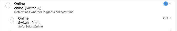

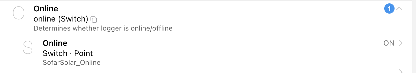

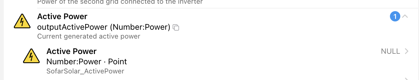

installation done, I needed to activate it from CLI. No I can see in GUI as well. I started configure channels, basically map them to the Items.
Now got:
2022-11-29 13:06:25.371 [WARN ] [al.protocolv5.UnknownResponseHandler] - Unknown response from logger sofar, length 43: A51000101500133787998B02019240000022040000B7B4856306007E15A50100104700143787998B004E15
2022-11-29 13:04:25.360 [WARN ] [al.protocolv5.UnknownResponseHandler] - Unknown response from logger sofar, length 29: A51000101500103787998B02011A400000AA030000B7B4856306008A15
2022-11-29 13:02:25.350 [WARN ] [al.protocolv5.UnknownResponseHandler] - Unknown response from logger sofar, length 14: A501001047000F3787998B004915
