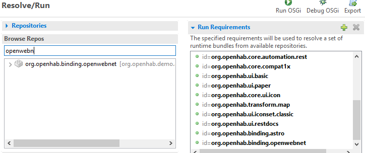

I managed to create my binding, but when i run app.bndrun → Run OSGI, my binding won’t be listed in my Paper UI and the console give me following warnings (picture). Do i have to create a new log4j file? Any suggestions? Thank you in advance!
I took the freedom and changed your post to the Develoment category.
did you drag your link from the list on the left to the one on the right?
@sihui Thank you
@gozilla01 Yes, i did
Am i the only one having this specific type of problem? There seems to be no other thread dealing with it.

  • Double click on app.bndrun
    ** Note problems: **
    In the window for dragging in Run Requirements the Openwebnet binding is not present, Astro yes.
    I ran several tests to solve it but nothing …

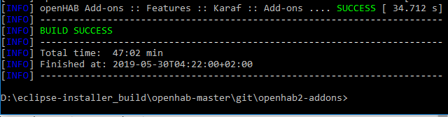

  • From windows command prompt, by command cd I move under the openhab2-addons folder and compile it all with the command mvn -DskipChecks -DskipTests clean install -U
  • I open Eclipse
  • I dragged the Openwebnet and Astro bindings to Run Requirements
    (the command from the prompt solved the problem, there will be another way to avoid waiting 40min ???)
  • ** Never used the Resolve button

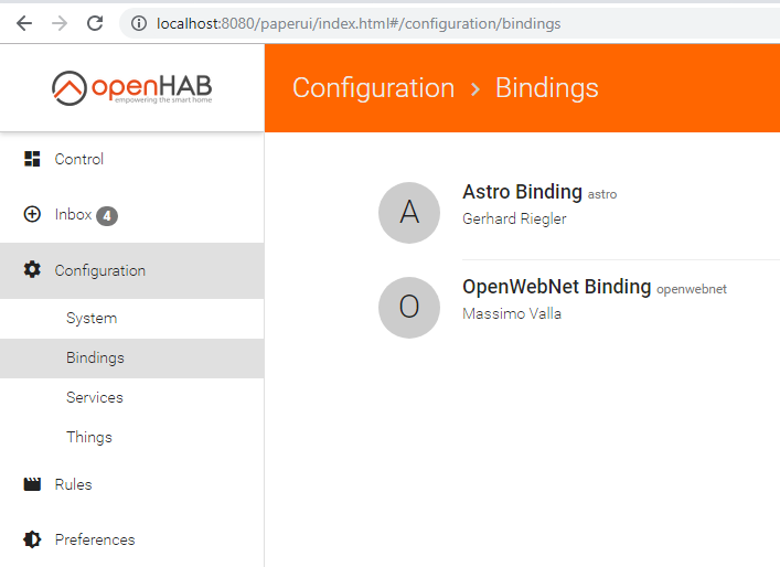

  • I press button Debug OSGi and wait for it to finish loading
    Note:
    The first time it doesn’t load Openwebnet but the second time it does.
  • From the Console I see a series of WARN and ERROR
  • From browser http: // localhost: 8080 / start / index, usually waiting for preparation of PaperUI

My own binding is shown on the left window and i can drag it. The problem is, when i drag a binding (e.g. astro) to the right side and run app.bndrun, i get errors (in the picture) and http: // localhost: 8080 / start / index is empty.
