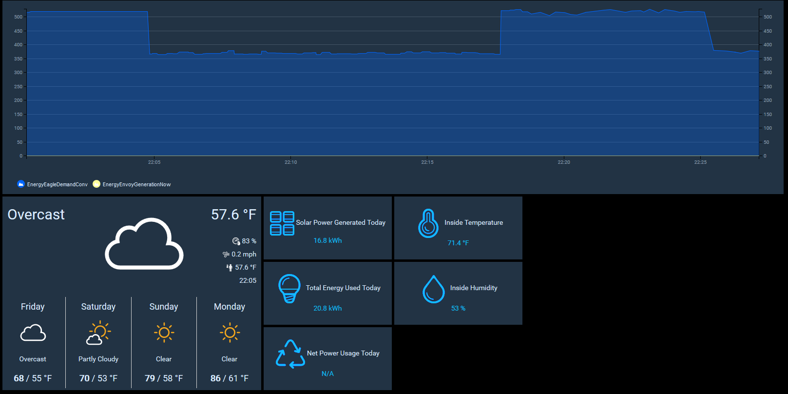

Hi Thomas,
I’ve been running the binding with 2.3.0 RC1 and RC2, for what I’m doing it’s doing what I want. Thank you for creating this local binding!
Here is what I created in HABPanel, still a work in progress!
Greg
