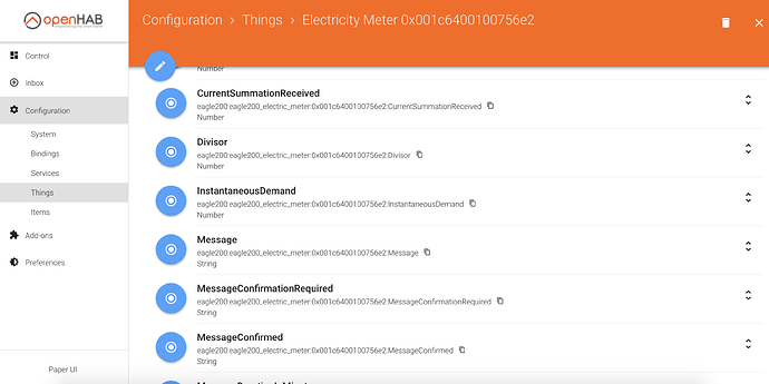

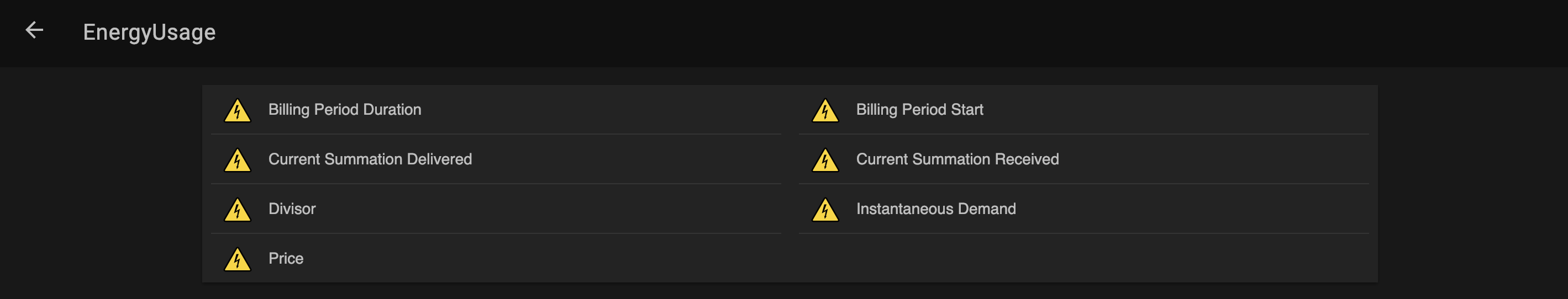

Hi Thomas,
I was finally able to get my Eagle re-added working. I still have blank channels. I added a trace to the binding. Here is the output:

The result in the Paper UI (no data shown):

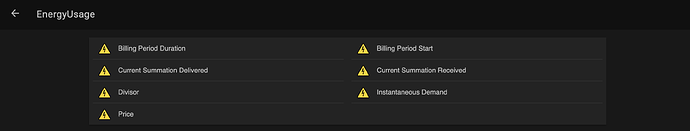

My Sitemap output:

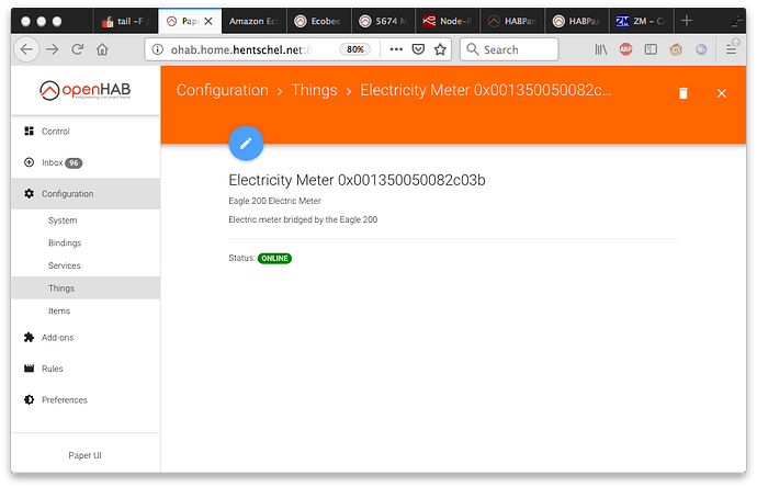

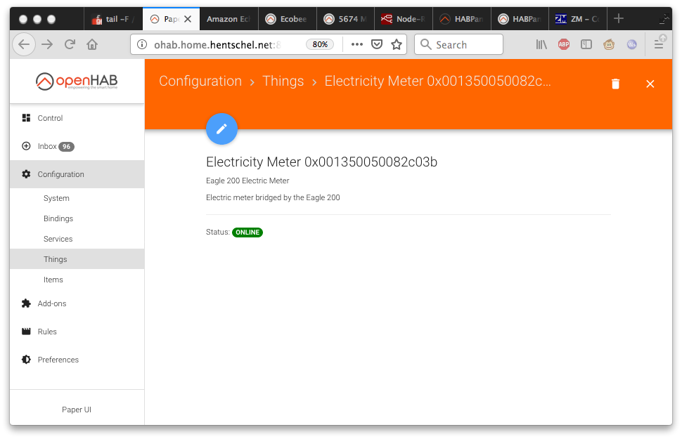

At some period of time after initially finding the meter, the PaperUI things file will no longer show any of the items anymore.
Humm, that’s interesting, it doesn’t show any meter channels for me in paper ui:
Also, I noticed you mapped those values to String items, I mapped them to Number.
