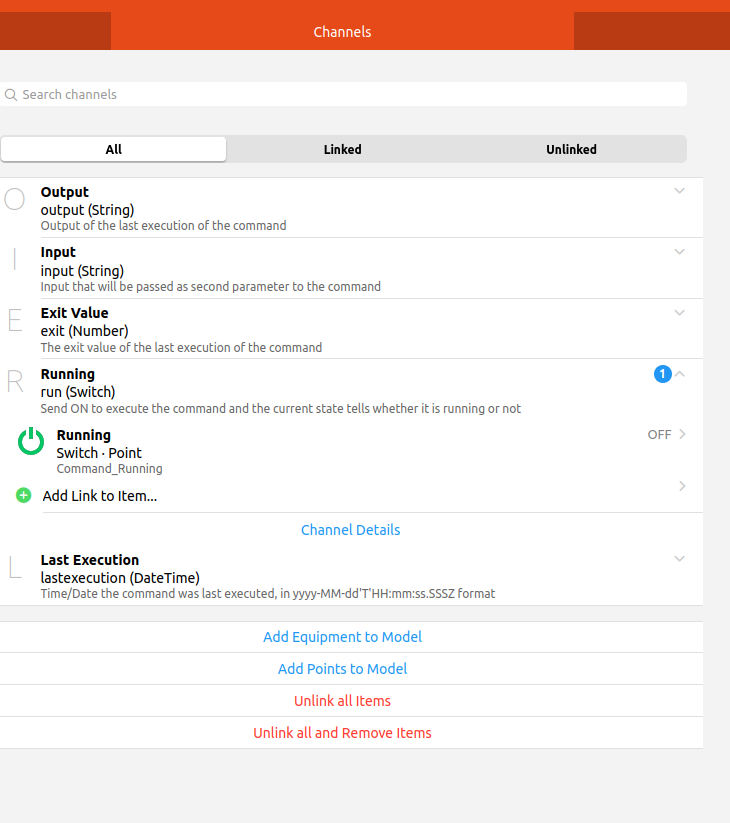

@Wolfgang_S thank you for your feedback. I will start with the command line because I know that the below one works when I ssh to my system. I can hear the sound.
mpg123 -f 2000 /etc/openhab/sounds/doorbell.mp3
So I tried to recreate through a rule and I installed the Exec binding (screenshot below for the “Thing”, “Channel”, “Item”, and “Rule”. I would love the leverage the interface as much as possible. When I run the rule no sound - I am close but something is still off. BTW the log doesn’t show any errors. Item is switching state as expected it just the sound isnt coming through…
