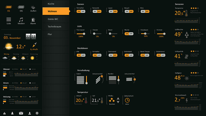

I had a challenge for a kind web designer cause I’m lame at web design but I love pretty UI : reproduce this very beautiful template of panel made with CometVISU/Knx and adapt it to HABPanel/OpenHAB.
Is someone ready for this challenge ?
Cheers,
Feji.

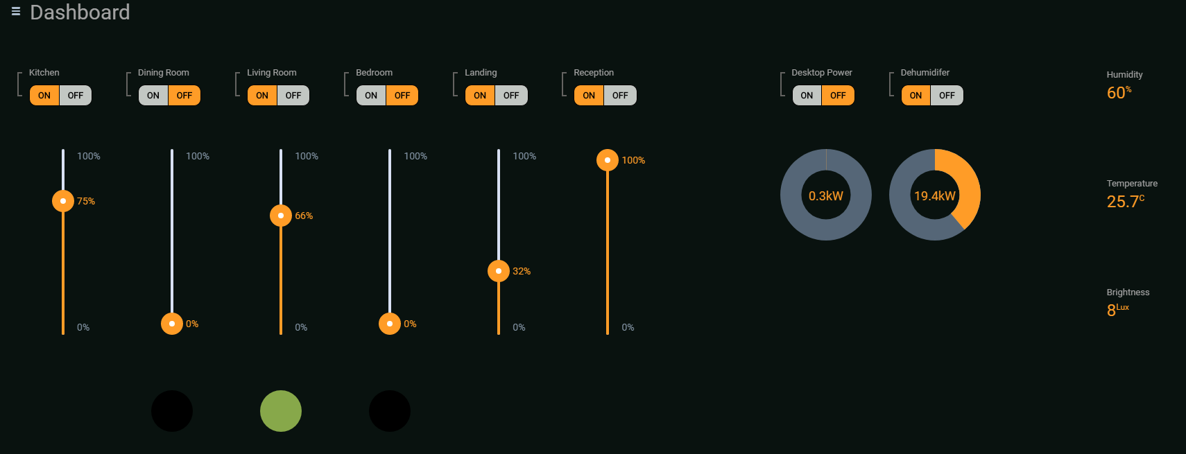

[image]
You cannot provide your stylesheet inline because “reasons”, rather you have to write a file like below and put it in the static files directory of your openHAB server (conf/html):
:root {
--body-bg: #333;
--primary-color: #888888;
--box-bg: rgba(255, 255, 255, 0.1);
--icon-color-filter: invert(90%) sepia(0%) saturate(0…
Hey kubawolanin, how did you do to only change the color of the icon instead of the whole square when activated ? is this something easy to make or I need te reprograms all my icon !?
@kubawolanin can you tell me the values to use for a CSS filter to match dark orange for svg images?
ysc
(Yannick Schaus)
July 2, 2017, 4:08pm
14
Edit: I started a new topic about the implementation of this in the HABPanel Examples category
Examples dashboard of HABPanel and descriptions how to create them.
This is another example of using an additional stylesheet file (a new option in 2.1) along with custom widgets to change HABPanel’s appearance significantly.
The design has been first suggested here: New design talent wanted!
Screenshot
[image]
Note: it’s optimized for a 16:10 aspect ratio, YMMV.
