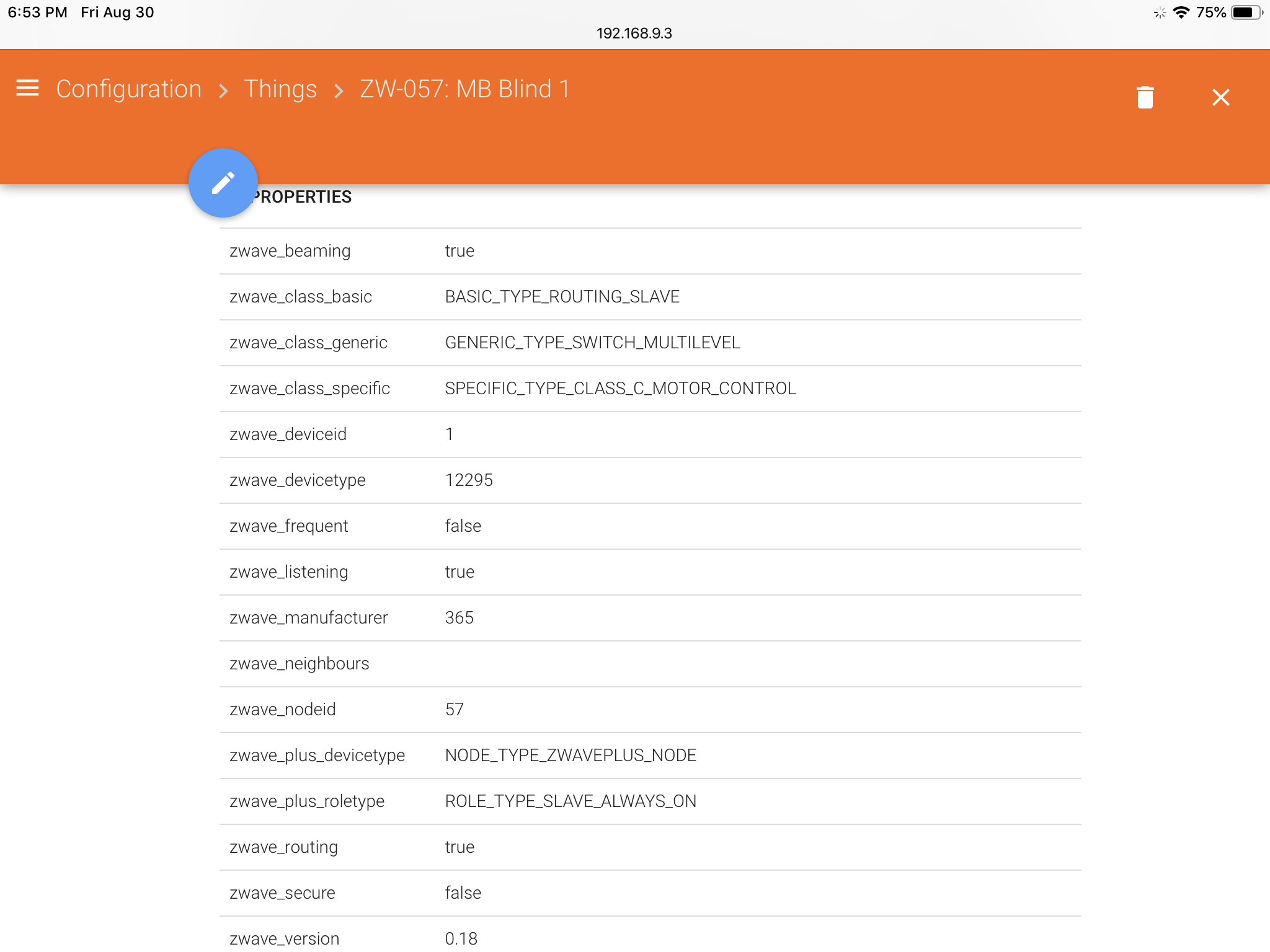

I am just switching my big installation from Vera to openHAB. So far it’s going well…but I have some Finesse Mini blinds that show as unknown. They paired fine but don’t have any linked channels…

Yes, I definitely have the ZWave binding installed…I have 50+ other nodes already up and functioning. I am not using any Vera binding because I have already transition to openHAB and powered down the Vera. My issue is that I have a device that does not appear to be in the ZWave database and shows as an unknown device. I am looking for guidance as to how to resolve this. Can I make it known and get it enabled by myself or do I need to wait for someone lease to add this device to the public device database?
First check to see if it is already in the database. If you are running the stable or testing version your database is not current.
You can move to the latest binding if your device is in the latest released database.

I just looked and we have no devices from manufacturer 016D in the database.
@tvipond Chris is the developer of this binding and very dedicated here.
If you post the xml and, preferably, a link to an online manual we can get this added.
The hard part is then waiting for it to trickle up to the latest snapshot binding so you can use it. I have been though this process myself.
Correct, I’ve read lots on the forum and checked the database…to no avail…I did come across Chris and that was my next plan…to send him the XML. I’m running the snapshot from less than a week ago.

Unfortunately the manual does not provide any information about associations and configuration parameters and I could not find anything in the world wide web.
How can I tell whether the snapshot contains the new database or how can I tell which version of the binding I am running to ensure I have the latest?
I can only assume the database is not merged yet, or I am doing something wrong. Is what I have listed below the correct process for getting the new database?
I followed all the instructions I could find on how to update the binding/database.
I am using the 2.5 Snapshot, installed early last week.

The things I was having issues with were some electric motors that control blinds and drapes…these specific things are Nodes 57 through 61.

But at this point you missed the most important step: you needed to download the latest zwave 2.5 snapshot binding version with the database changes merged to it.
That won’t work at all: you installed your old binding again which does not help. You need to download the latest zwave snapshot and drop it into your addons folder. That’s it.
