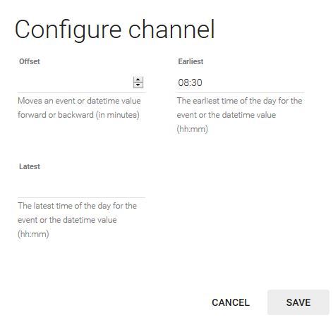

However, I cannot get it to work properly.
I defined via PaperUI a thing and linked an item:
I would expect now a channel trigger available at 08:30 in the morning to open my rollershutters, but nothings happens (astro2 in debug):

but not one single entry on any log for earliest=08:30.
Are my expectations how the binding should work wrong?
You only set the start time channel, that’s only for displaying the value. If you want a channel trigger, you have to use range event
Ahh, thanks :sunglasses:
Will try again and report back …
Okay, got it working now. :slight_smile:
