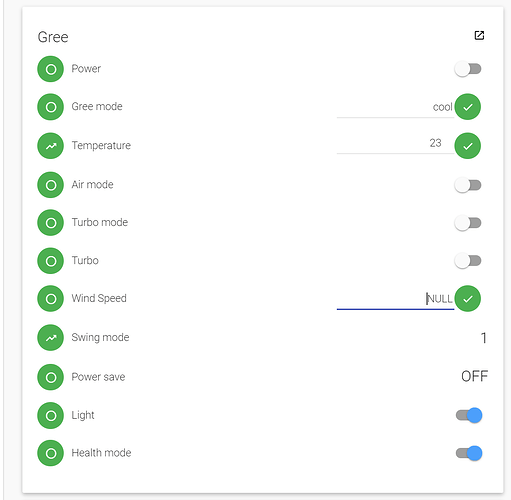

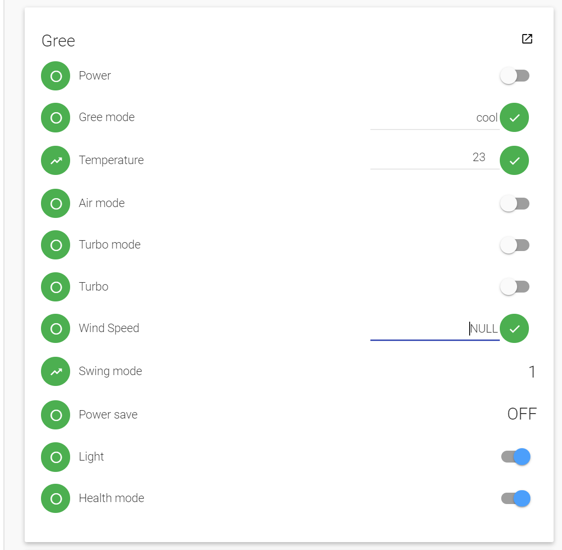

which UI are you using?
Check what PaperUI displays
It looks like the issue has solved itself :slight_smile:

Autodiscovery works. Windspeed is recognized as a string automated:
It requests value in Paper UI, do not bring up a list. So it can be preconfigured in sitemap.
ok, found the problem. I mixed item-type for windspeed and quiet, this should be fixed

Basic UI, Paper UI and Android APK. It’s the same on everyone.
try the build, I also reworked the option lists
