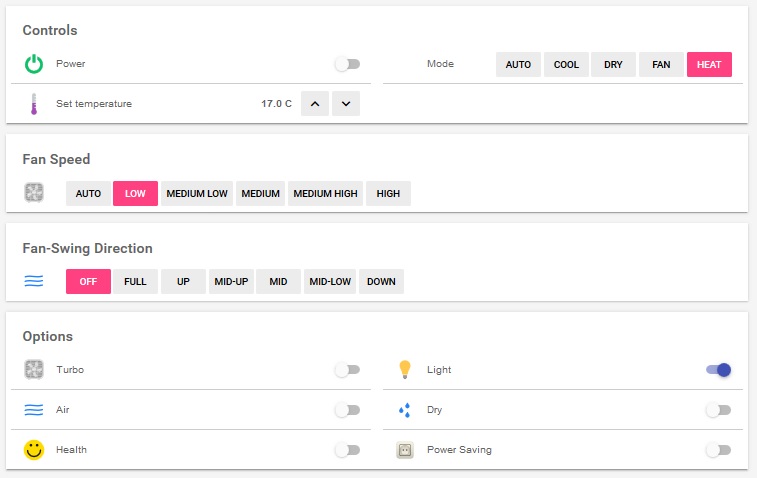

Below is a screenshot of my sitemap example.
