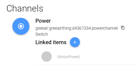

Hi Hector,
Good news is that the problem is not in the Binding :slight_smile:
(Since the item is being updated in the Events.log file, then the binding is working correctly)
Can you check the name of the Power Item in PaperUI?
  • Open PaperUI
  • On the left, click ‘Configuration’ then select ‘Things’
  • In the main window, click on the Thing that is your Air Conditioner.
  • (You should now see all the channels for the Thing)
  • Click on the blue circle on the left of the “Power” channel
  • (Now you should be able to see the Items linked to that Channel)
    (In my case, the item was auto generated by PaperUI and looks like : “Power (GreeAirConditioner_Power)”)
    Do you have more than one linked item? You should only have one.
    There may be more than one item linked to the channel (One generated by Openhab and the one from your .item file).
  • Delete any extra items linked to the ‘powerchannel’ channel.

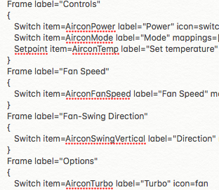

  • Now go back to your sitemap file and make sure the line item matches the item you saw in PaperUI :
    Switch item=GreeAirConditioner_Power label=“Power” icon=switch
    (Make sure the item in the sitemap file matches the item you saw in PaperUI)
Let me know what are your results…

ITEMS FILE
SITEMAP FILE

HI Hector,
Sorry for the long delay in replying (I’ve been on vacation without internet)
Looking at the log, the app is querying the airconditioner for status and it’s replying that it’s ON.
2018-04-05 23:56:07.604 [TRACE] [nding.greeair.handler.GreeAirHandler] - Response from device: {“t”:“dat”,“mac”:“f4911e09cb56”,“r”:200,“cols”:[“Pow”,“Mod”,“SetTem”,“WdSpd”,“Air”,“Blo”,“Health”,“SwhSlp”,“Lig”,“SwingLfRig”,“SwUpDn”,“Quiet”,“Tur”,“StHt”,“TemUn”,“HeatCoolType”,“TemRec”,“SvSt”,“NoiseSet”],“dat”:[1,1,18,0,0,0,0,0,0,0,0,0,0,0,0,1,0,0,0]}
Try to unlink and delete the item linked to the power channel and recreate it using PaperUI instead of defining it in the file.
