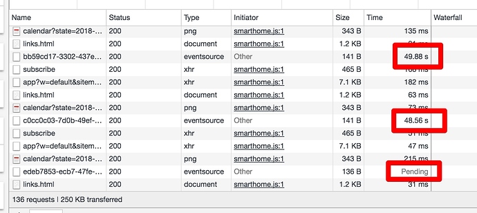

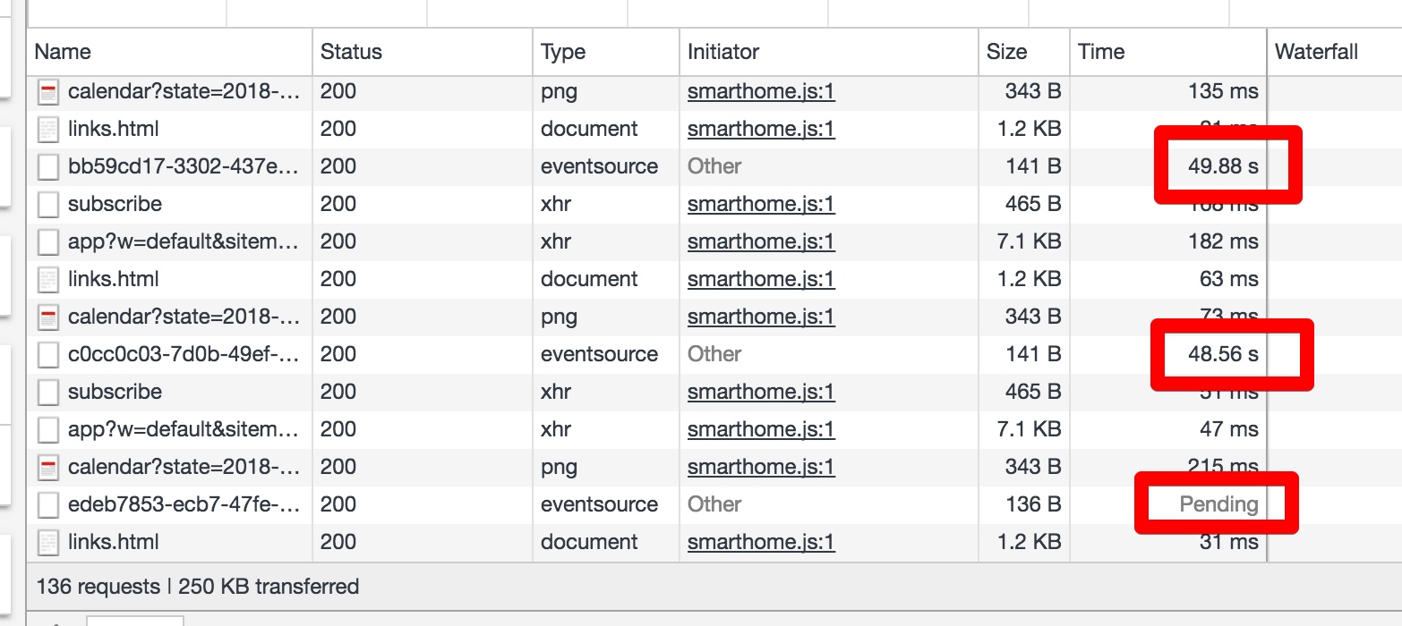

The the other case, I see some strange behavior in the browser console. And, I get the “Offline: waiting for connection to become available” message every minute. In the console log below, you can see where the eventsource REST API call blocks for about 50 seconds.

What you see in your browser console is very probably normal. The requests ends when a data is received and the last one is in pending state waiting for an update.

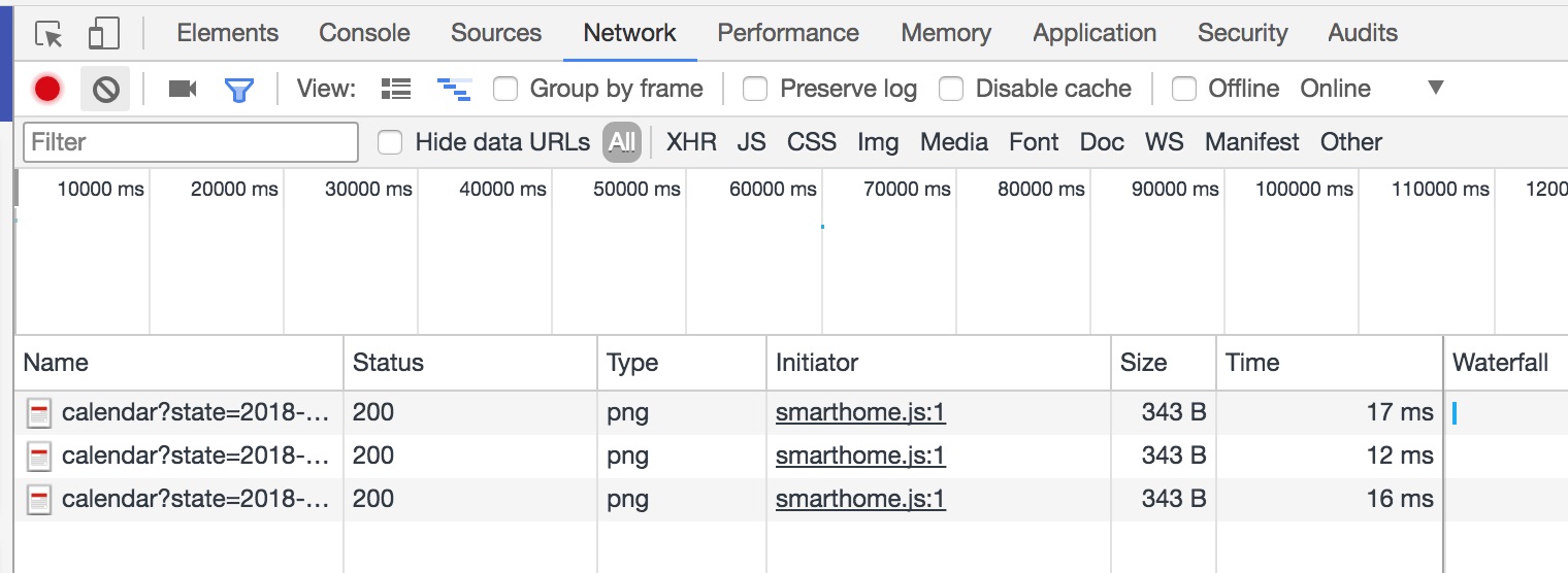

That’s because 1140 works correctly. :wink: : On 1140, I see this in the console, which is what I would expect. Every minute the state updates through the existing SSE connection.
Based on the above, this doesn’t look normal. It looks more like the page is refreshing?
Agreed. It does look more like this one SSE connection crashes on DateTime event updates · Issue #4678 · eclipse-archived/smarthome · GitHub
