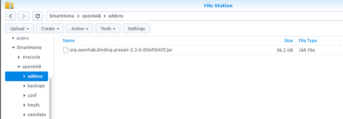

I have OH 2.5 installed on Synology Diskstation, it already works fine with my Xiaomi devices.
Now I need to install this Addon
So I put jar file to addon folder and gave the restart to Diskstation but nothing happened. I still don’t have option to add such thing under PaperUI.
Any suggestions how I add it to my OH setup?

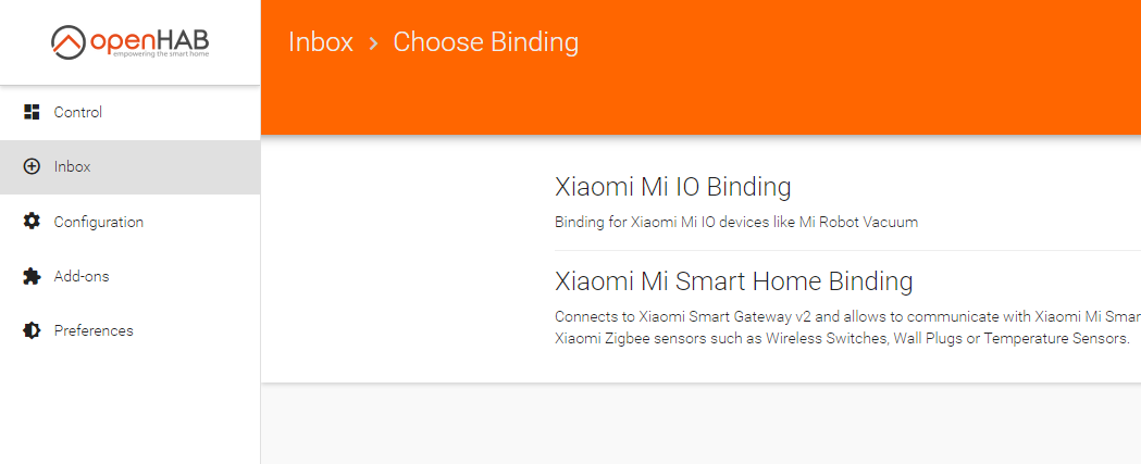

Inbox doesn’t have this binding:

When adding manually jar’s to addons folder, a restart of openhab is required.

Hello Remo,
thanks for the input! Sorry I didn’t mention that, I tried to restart it with no luck.

As per my investigation the issue was caused by missing ‘addons’ folder during OH installation. Installer UI was clearly requesting to create this folder prior installation, what I missed.
After the proper OH reinstallation this is fixed.
