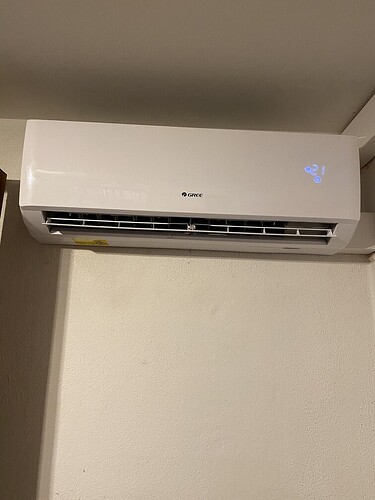

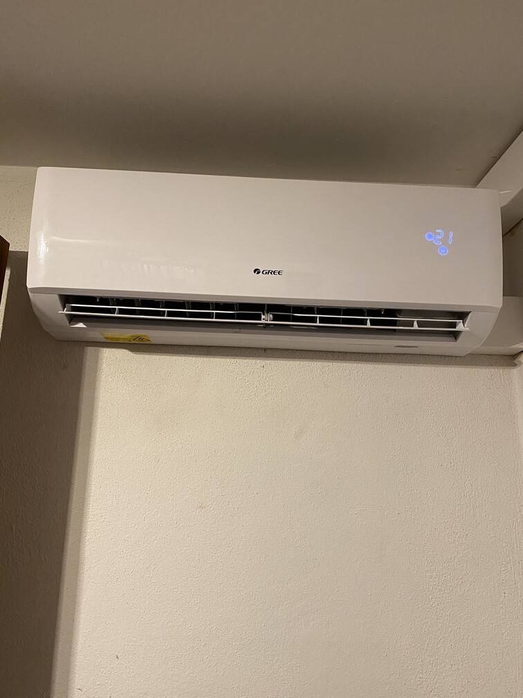

my unit got installed today😎
but I‘m to stupid to setup WiFi

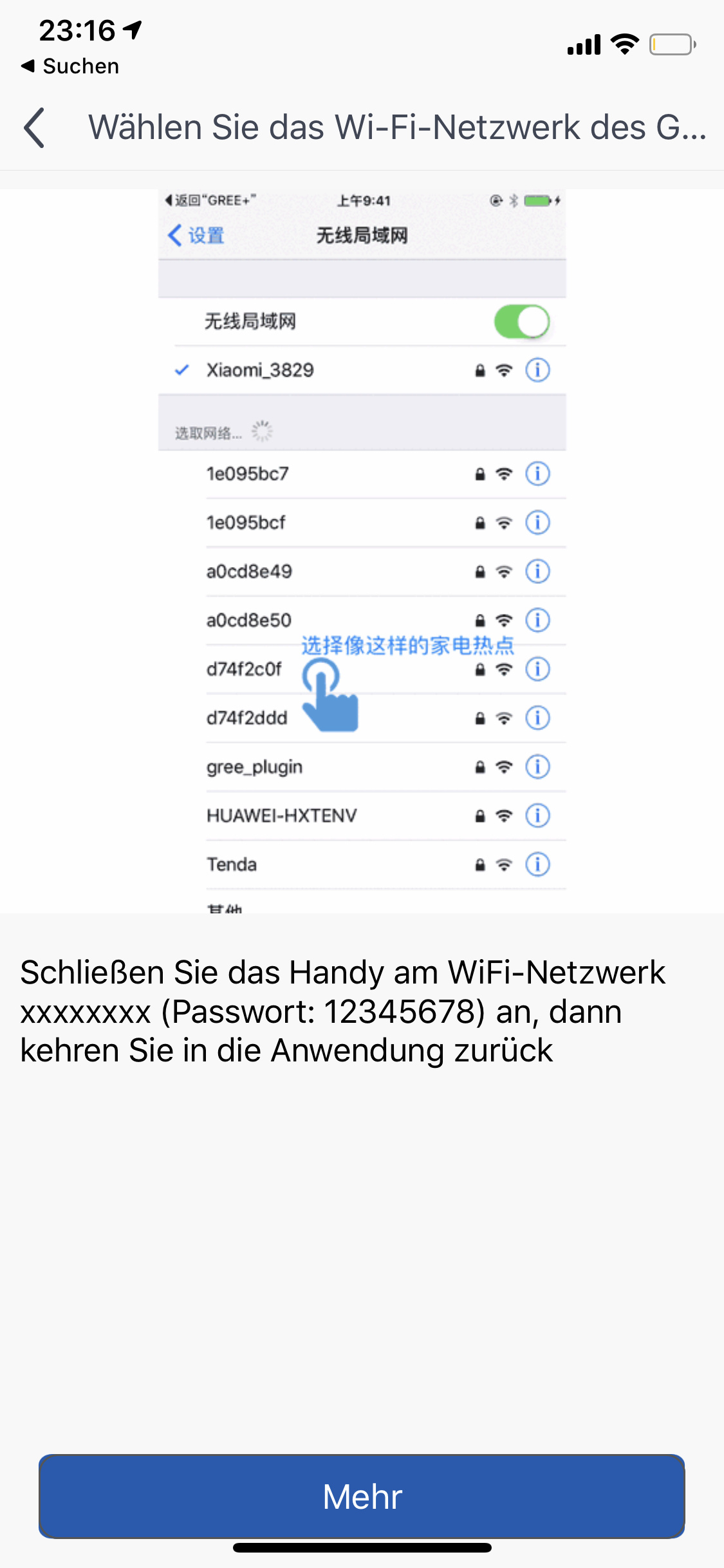

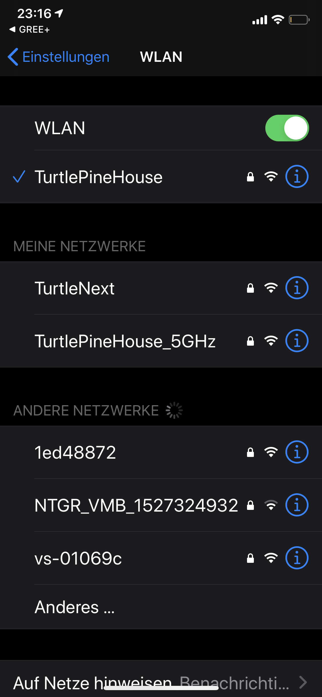

I created an account in the app, turned on WiFi (pressed the button once, manual says 10s, but this doesn‘t work). I see a hey digit WiFi name, but where to get the password?
The code printed on the label doesn‘t work
Heeelp :slight_smile:

Model GWH-12-QC-I

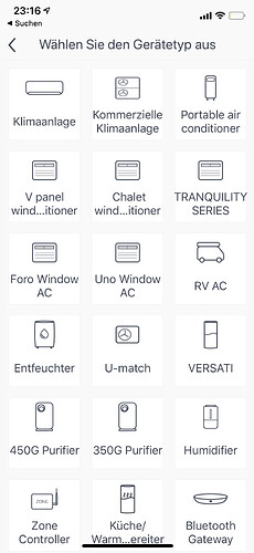

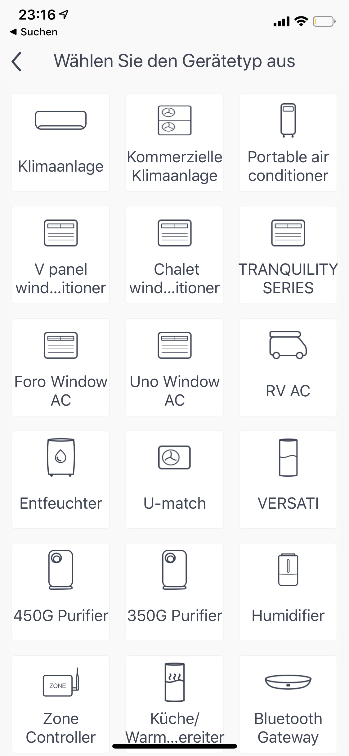

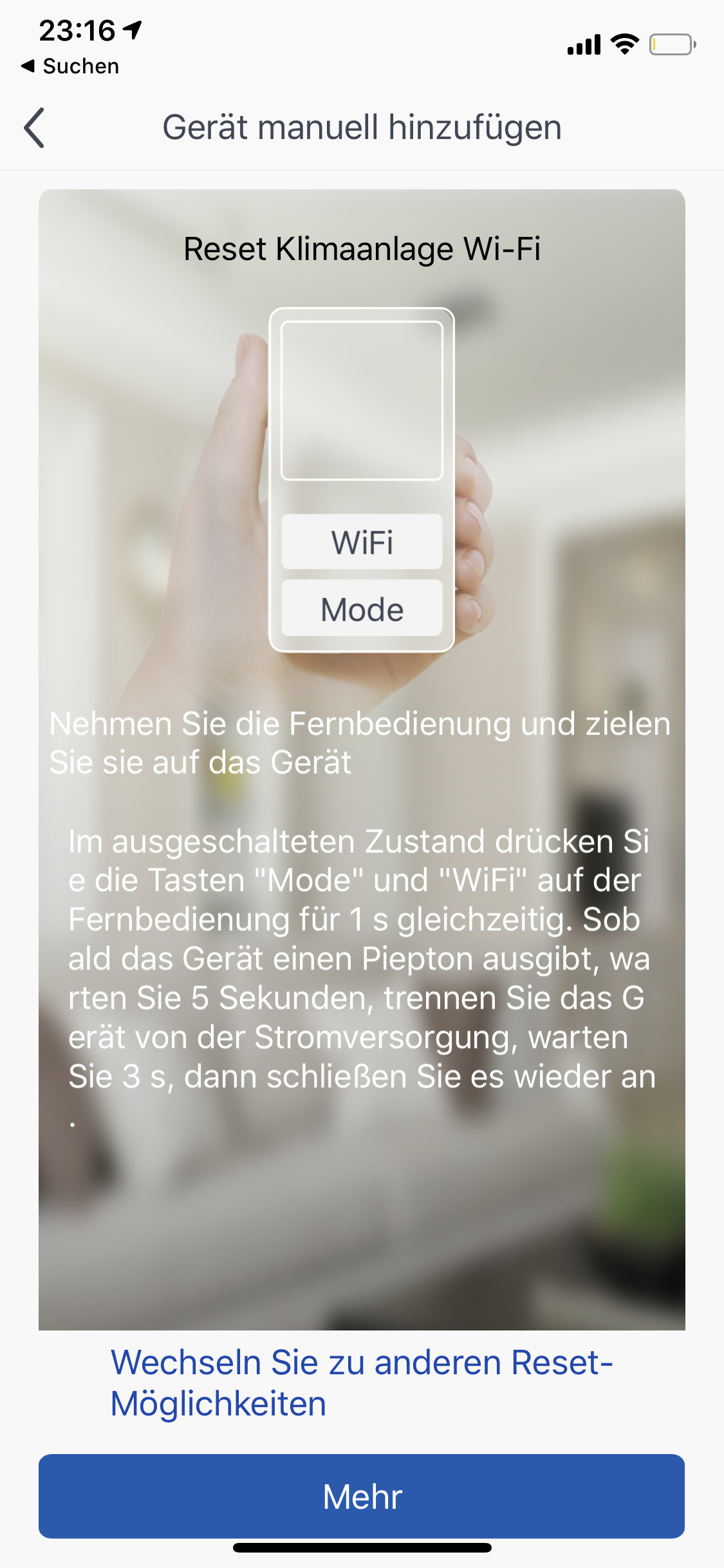

That’s the App flow and last one is the screen where I get stuck

When the unit shows up with the hexcode as WiFi network it’s not connected to your Home WiFi
Yes, but just try to initiate connection using app. If it fails, but Gree WIFI disappear check your router if such device with MAC address is already connected.
No, I can’t get out of the loop
  • App requests me to select the Home WiFi
  • I’m connected
  • I return to the App
  • it shows “connect your mobile to the WiFi”
  • throws me to the iPhone’s WiFi settings
  • and I’m never able to proceed in the app
    kind of an endless loop
The AC’s wifi is still visible, but I can’t connect to it.
Do I need to use the code on the sticker (under the bard code?)
How to obtain the AC’s WiFi password?

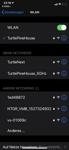

When you’re trying to connect using app you have to be connected to your home wifi and then try to initiate connection - app should find your AC. After that should ask you for proper WIFI for your AC and pass.
I’m connected to my home WiFi before starting the App. That’s the screen I get stuck. If I click Next if sends me again in the iPhone’s WiFi settings:
So it seems that the App thinks that the phone is not connected to WiFi
Your network must be connected to Internet.

I have VPN on my iphone which is automaticaly switched on when I am connecting to the new wifi.

the password to AC is simple: 12345678

Guys, @smarthomepch provides the magic: Password 12345678, I never considered sich a bad implementation, in fact this is a joke.
